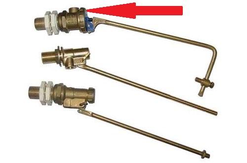

The rubber washer is in the end of the
piston. Taps have jumpers. Especially the cold ones. ;)
It should not be a BS1212 Part 1 if it is fed by the mains. It should be a Part 2.
If it is you'll need a Part 2 diaphragm washer. Looks like a liquorice Pontefract Cake.
First, isolate the valve or turn off your stopcock.
Undo the big nut (red arrow) and remove it, along with the float arm.
Remove the old washer, noting which way round it is fitted.
Reverse the procedure with the new washer.
Top; Part 2, off which some TGB has nicked the sparge pipe
Middle; MOH (Ministry oh Housing) or Portsmouth Pattern
Bottom; Part 1

Hiya all,thanks for your help ealier ^^^ i have managed to change the washer, all went pretty well - wwas going to take the big nut off and take it out the roof but this just seem to spin so i left it a long! undid the part were the washer sit and could see straight away why it was making the noise wasnt in the best of condition!
noise sorted and all seems to be ok!
One minor point water seems to weep/drip out of the plastic spout a little around were the spout fits in to the brass part, will this stop onece the ball valve completely shuts off? or is it just because its worn?
guessing it will be ok?
migt be an idea to fit a new ball valve complete in the future, is the issue i raise a common one and anything to worry about??
