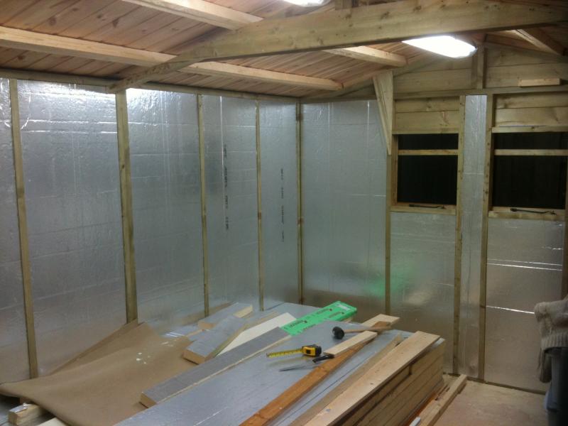

Before I install roof insulation boards and seal and line the walls of a timber garden building, I need to be sure I'm doing the right thing before I start. This is my first significant DIY build project so informed guidance is appreciated.
Following advice from a previous post I've installed foil-covered 50mm Eurotherm boards between the 60mm wall support timbers (external wall 22mm T&G), leaving a few mm between the T&G wall and boards, and also the vertical timbers standing a few mm proud internally. I've uploaded an image of the building internals as it is at the moment.
Ahead of my questions, I propose to do the following...
Walls...
1. Vapour-seal all gaps with 200mm foil tape over the timbers to the cavity boards.
2. Attach 4" x 1"s horizontally at right-angles to the wall timbers, running the full length of the walls. These will also provide convenient behind-wall cabling channels at both floor and bench heights once fitted.
3. Tack a visqueen vapour barrier covering the horizontal timbers and then Gyproc soundblok plasterboards on top.

It sounds like you're really going to town on this shed! A drawing or sketch of your wall, roof, eaves etc details would help as it's difficult to work out exactly what's going on here.
In principle you are trying to stop moisture vapour from the warm air inside penetrating the building fabric and condensing in there where it can cause damage, while ventilating any space on the cold side of the insulation to remove any moist air and condensate that forms there. Your foil backed insulation and vapour barrier - (not sure you really need both!) achive the former, your ventilation gaps the latter, but I can't work out where this is exactly in your roof.

I've provided a sectional drawing which will hopefully clarify what I'm proposing to do as the prefered option. To conserve head-clearance (I'm a tall bloke) I would like to take advantage of the space between the roof support studs and tuck the celotex in there (as shown). The question here is whether the 3-5mm clearance between the celotex and the T&G roof will offer a sufficient breather gap - given the strong visqueen vapour barrier against condensation from within the room? I'm proposing to run the barrier down and over the top of the side walls (as shown), ensuring no opportunity for vapour entry into the small roof void from within the room. Also, should the felt ever develop a tear/leak (heaven forbid !), then any ingress would drain to the outside without damaging the decorated interior or electrical equipment.
My other question was whether I should seal off the 1" void between the gyproc wall and the thermal boards, or allow some small natural convection top and bottom into the room to avoid a vapour trap and possible mold? If of significant thermal benefit then I could seal the wall void entirely with visqueen, but if of little benefit then not worth the effort as it would avoid the need to seal socket cables which would run along the voids and emerge through the gyproc.
I don't really have a handle on how beneficial sealing such a wall void is likely to be for thermal improvement. Also, will the small ceiling void offer enough natural ventilation or would it be better to seal off the roof area entirely and simply add a further layer of roofing felt to reduce the possibility of undiscovered damage and rain penetration?
You absolutely do need a VCL with foil backed insulation between the studs.
I have seen tests where without a VCL, the gaps between the insulation and studs* act as cold bridges, and condensation occurs, though in fairness it is a low amount, it's still not worth it for the cost of a plastic sheet.
*Even if you fit the foam panels tight, you will either have a few tiny gaps, or some may develop as the timber shrinks.
Thanks Ratman for your information.
I bought a good roll of Visqueen for this project and other things (4m x 25m) so a non-consideration... Wall VCL is in :wink:
I did apply 200mm foil tape bridging the wall studs and around all edges of the foiled boards, but clearly not enough to avoid possible problems in future should the foil become stressed and breached with movement and beam shrinkage.
