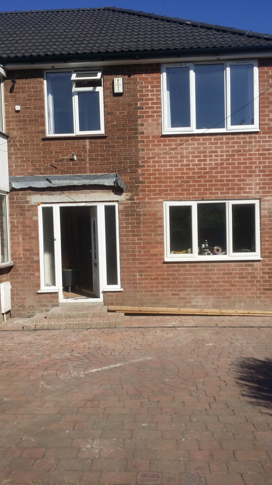

Morning all. Think it's a ledger board and not wall plate.
Starting on putting my front canopy back up after removal for new extension. They used frame fixings on the one which was removed. Was all loose and basically just ripped it off the wall. Planning on using chemical fixings but what size. It's 5.6m width and using 135mm × 37mm treated timber. Was thinking M12 × 160 at 600mm spacing. Would that do? Never used the chemical stuff before. If I was using the M12's would it be 12m drill hole a good pump of anchorset and knock in bolt?
Any advice welcome.
Thanks guys
