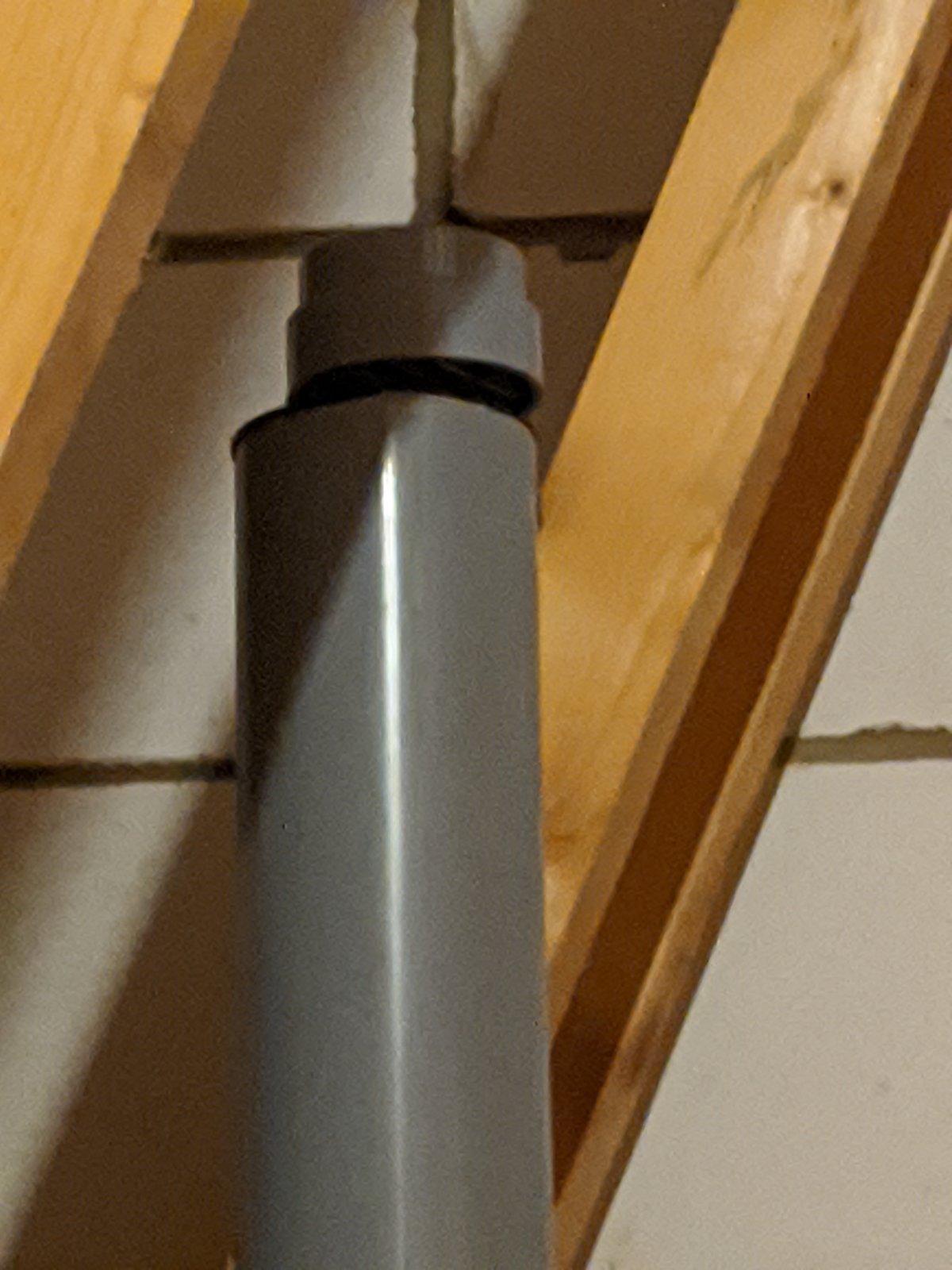

There is a vent pipe that emerges in the loft, based on my non expert googling this is an air intake valve. Photo attached, but it's hard to access this (loft not boarded) and I don't know what it should look like. Looks off center to me, but I don't know what it should look like.
Pull it off and see if it cures the problem
Hard to get to as the loft isn't boarded and there is thick insulation so I'm not sure where I could stand to get to it. I'll think I'll have try to get the developer to send a pro up there, but they seem reluctant to admit the problem is inside the house :(
By builder I mean a house building company, I'm assuming the plumbing was done by a sub-contractor.
No wet wipes have gone down any drain or sink while we've owned the house from new, and the problems have only started in the last couple of weeks.
Sorry bud but unless you have had no family, friends or visitors you can't be certain also as I said it could be neighbours.
I guess I'm going to have to get some boards from somewhere and get up in loft tomorrow morning and prod the valve, check if that looks obviously working or not. Any tips what I should be looking for?
Just pull it off
Looks off centre because I think the plumber fitted a small one. They come in different sizes. Won't do any damage if you leave it off for now and get a new one later.

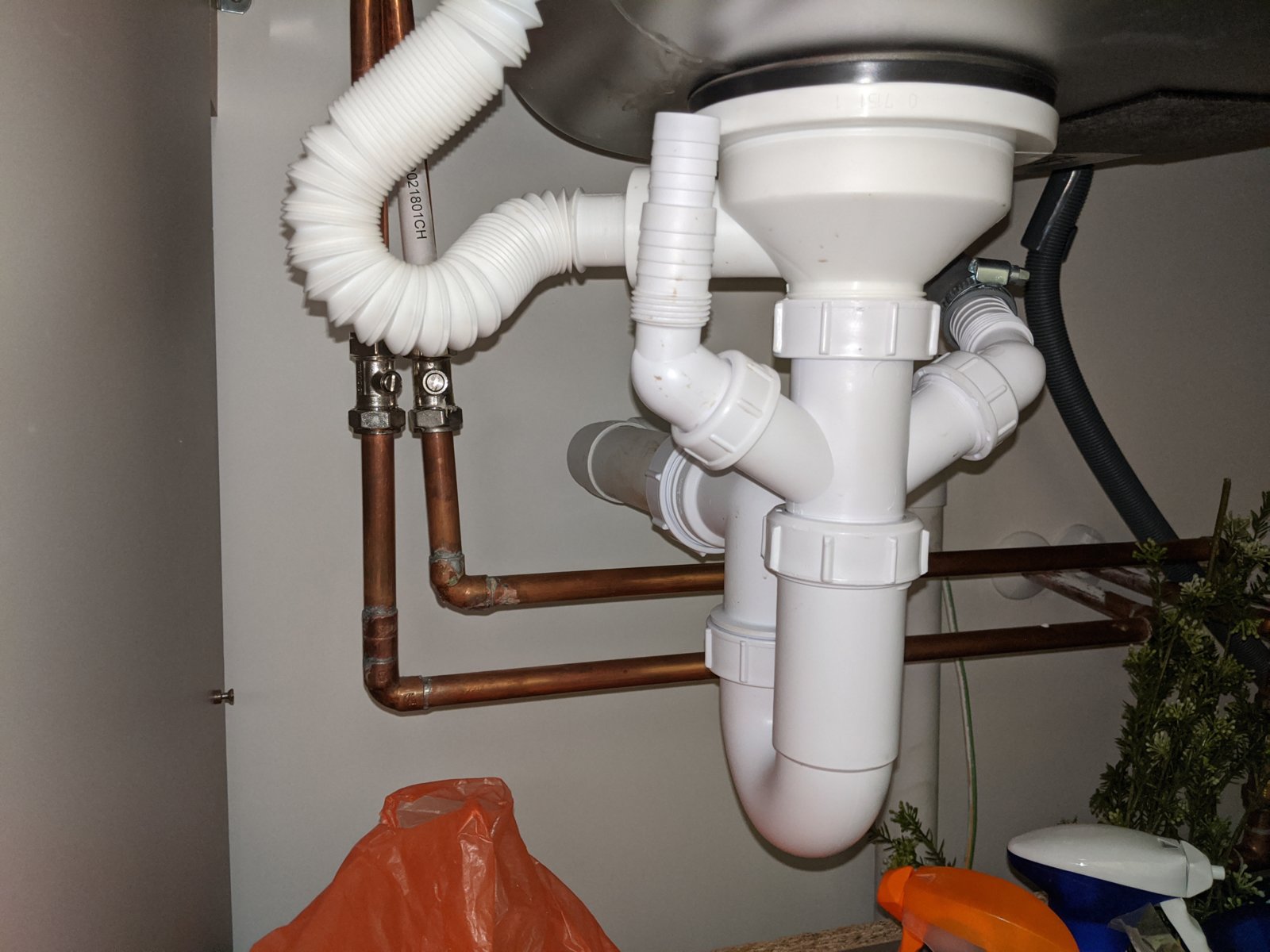

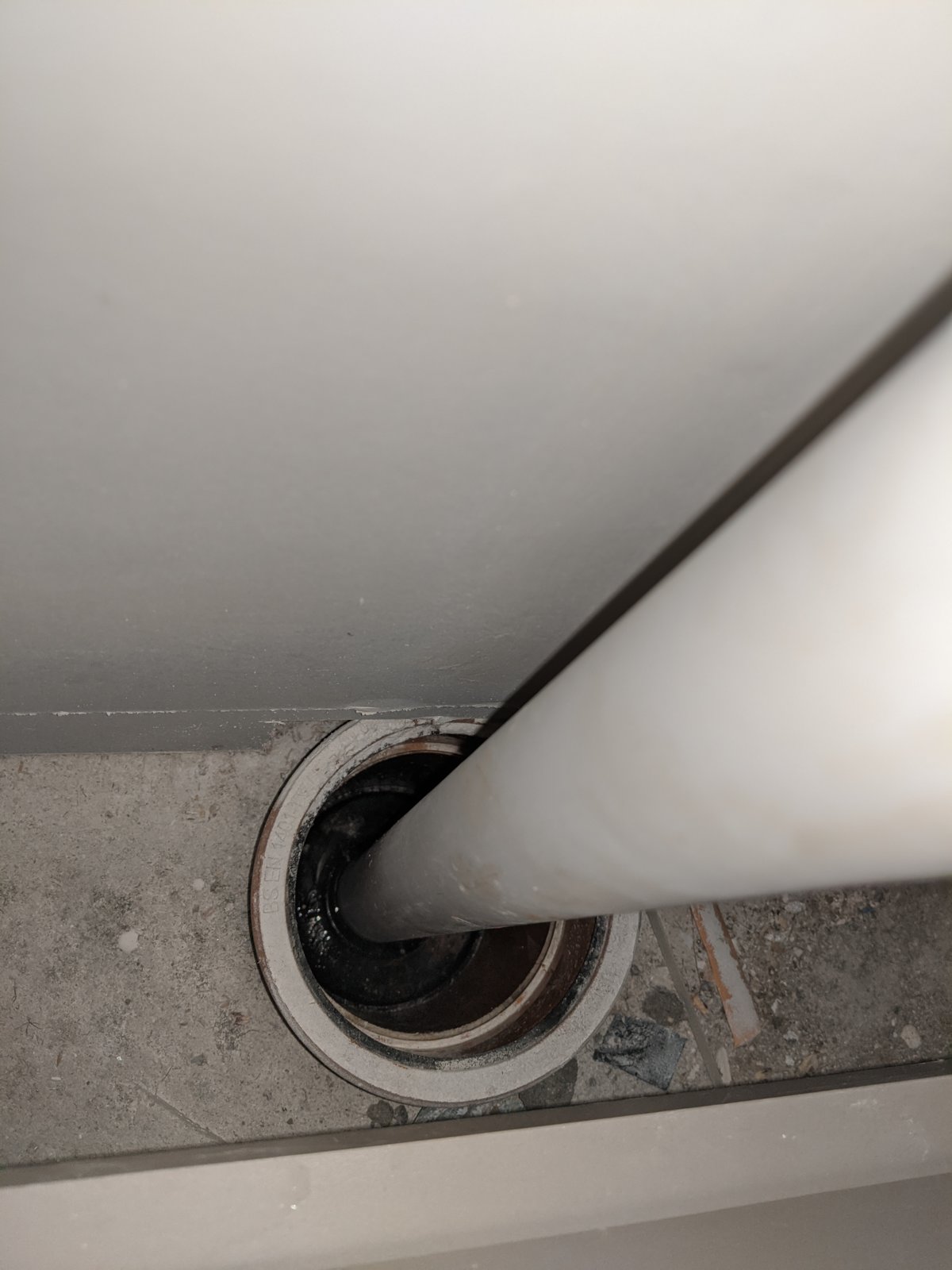

Any pics of kitchen pipe work your description sounds a little strange .?
These two show where the washing machine connects to underneath sink (there is also a blanked off second attachment for another machine) and where that pipework connects to floor. It seems to just rest on top of a rubber seal, this is what I can lift to let air in/out.
Washing machine hose is on right, blank space for second machine on left, connection to overflow behind that and the trap drains out backwards then down to floor in second picture.
Most obvious problems manifest at that sink, but seems to affect whole house.
