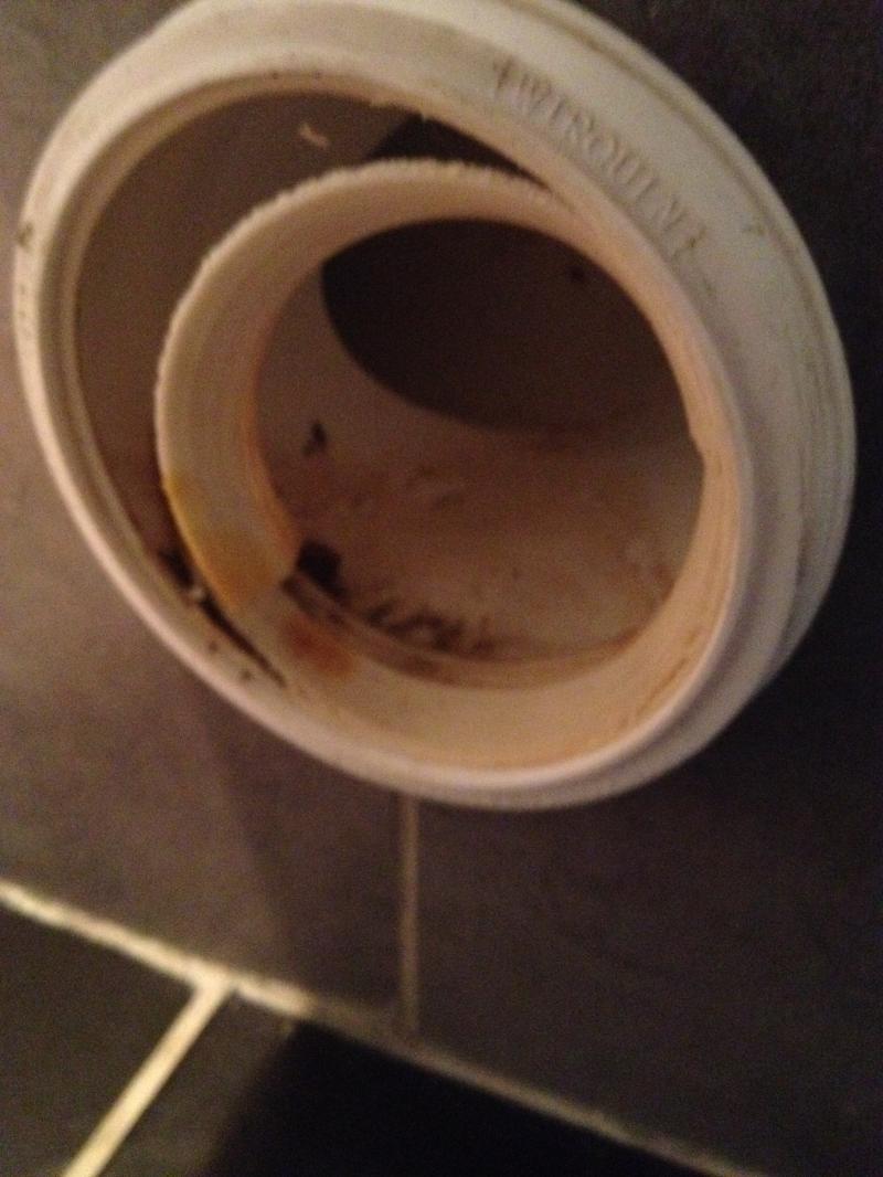

Looking for some advice. Whenever I flush my ensuite toilet water pours out from the point where the toilet outflow connects to the waste pipe. Having removed the toilet I discovered that the rubber seal has decayed
My question is can this be replaced rather than a new waste pipe, and if so, what would I need to purchase? There are so many different seals etc Im finding it difficult to nail down what I need
Any help would be much appreciated.
Many thanks
Try your local independent plumber merchants.
You need a seal for a Wirquin pan connector - you may have to buy a new fitting and steal the seal from it.
Remove the outer white flange from the existing connector and fit the new seal, refit the flange and reconnect the pan
