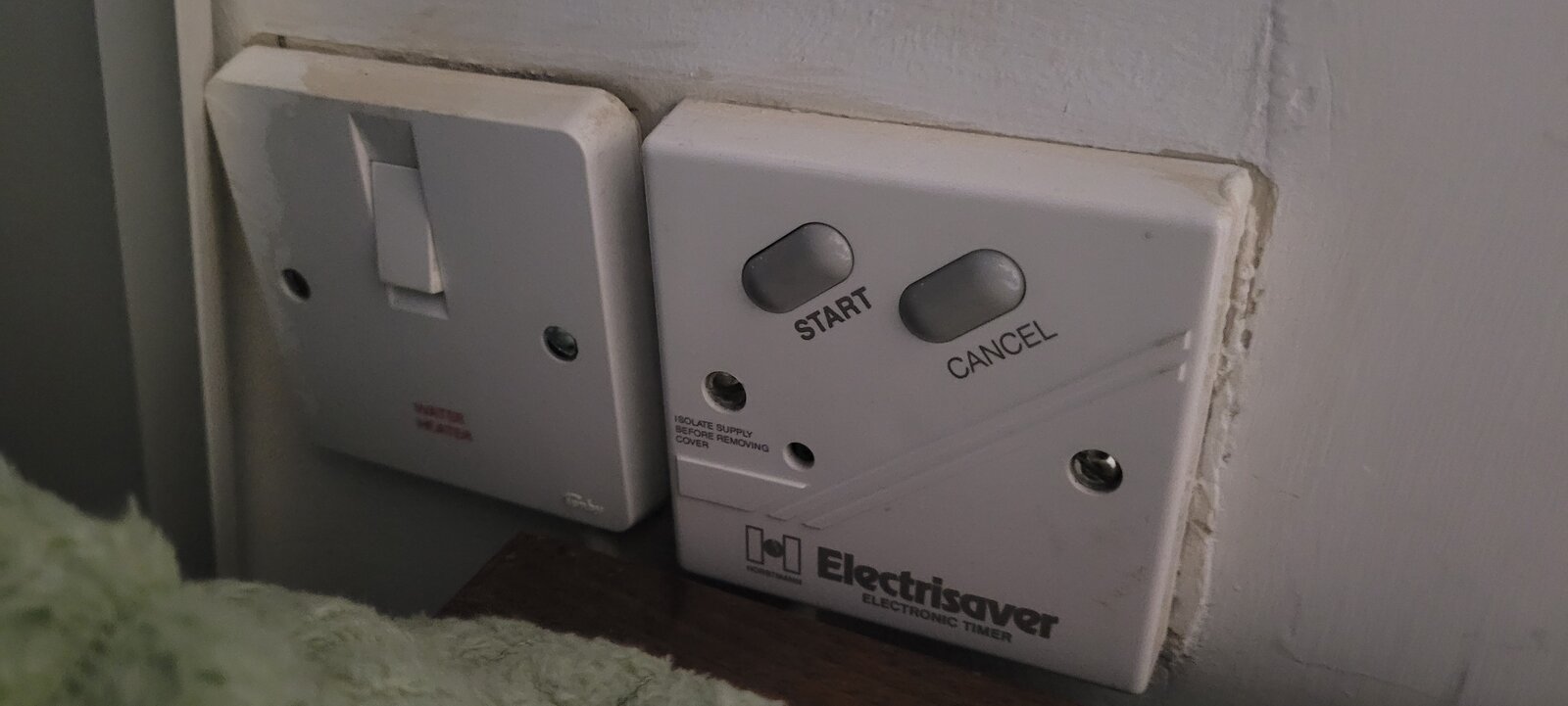

We live in a flat with electric heating only. Our bills are sky high, but I've noticed that we had the water heater button on always.
Is it my understanding that it doesn't need to be on and that we just need to press the Electrisaver button on for a few hours only.
Our bills are a bit high.
The idea of the Electrisaver, is that you press the button, it heats the water, then switches off after a time. Basically press and forget. I would expect the light to go off, or perhaps change colour, once it has timed out.
Do you mean button, or do you mean switch? The switch is supposed to be on.
The timer then heats the water when the button haa been pressed, and not otherwise
