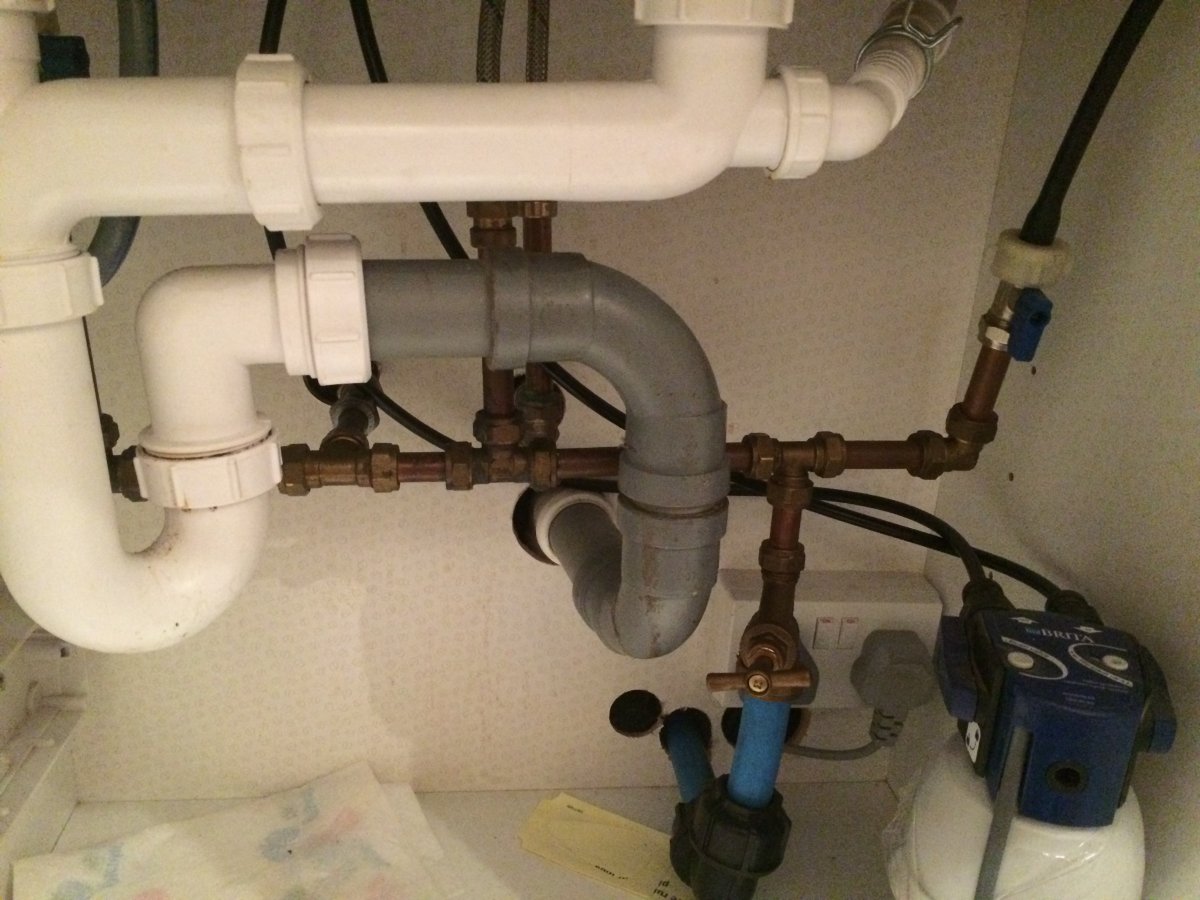

We had a new water supply and internal stop cock installed in a new location in the house with the new mdpe blue pipework as the main supply. However there seems to be no earthing to the water connection?
Should the earthing of the water main have been done at the same time as the installation of the new stop cock?
I may be wrong but i dont think that needs bonding as it cannot introduce a potential into the equipotential zone (your house).
Is that plumbing as diy as it looks?
You should be more concerned about the location of that socket with all those potential water leak spots around it. Is that damp or shadow one can see on walls and floor of cabinet.

As the service enters the property in an insulated material, there is no requirement for equipotential bonding.

Water can be conductive....... ( if it wasn't conductive then there wouldn't be all the fuss about electrics in bathrooms )
Some one might up (or down) grade the supply by replacing the the plastic water main with a metallic water main

Water is not as conductive as most people think! and according to BS7671 and guidance note 8, there is no requirement.
I have never come across any water undertaker replacing MDPE for metallic pipework, have you? As their standards are to remove metallic pipe and replace with MDPE.
I was being as bit sarcastic. In theory the water in a many metres of plastic pipe will not have sufficient conductivity to import a dangerous amount of current into copper pipe work that is within the equipotential zone. So it is is in theory not necessary to bond that incoming water supply.
Again with water mains it is most unlikely that a length of MDPE or other plastic pipe would be replaced with metal pipe. But not impossible, or as in friends house the MDPE pipe is about 2 metres long before it connects to the metallic water main and thus conductivity in the water could introduce a significant amount of current. In this case the plastic replaced a length of leaking metal pipe.
