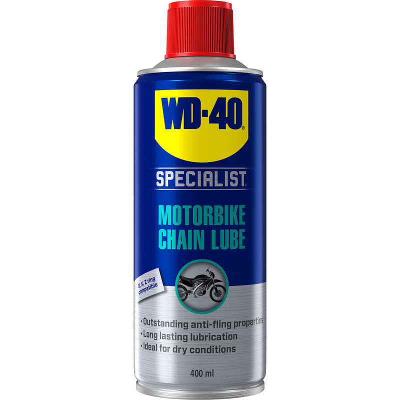

I think what people get confused with is the fact that it used to be a Water Displacement fluid (the 40th version tried) but nowdays WD40 is a BRAND. They make all sorts of fluids, not just one. Perhaps you should give this particular WD40 formula a try on your bike chain. ;)
