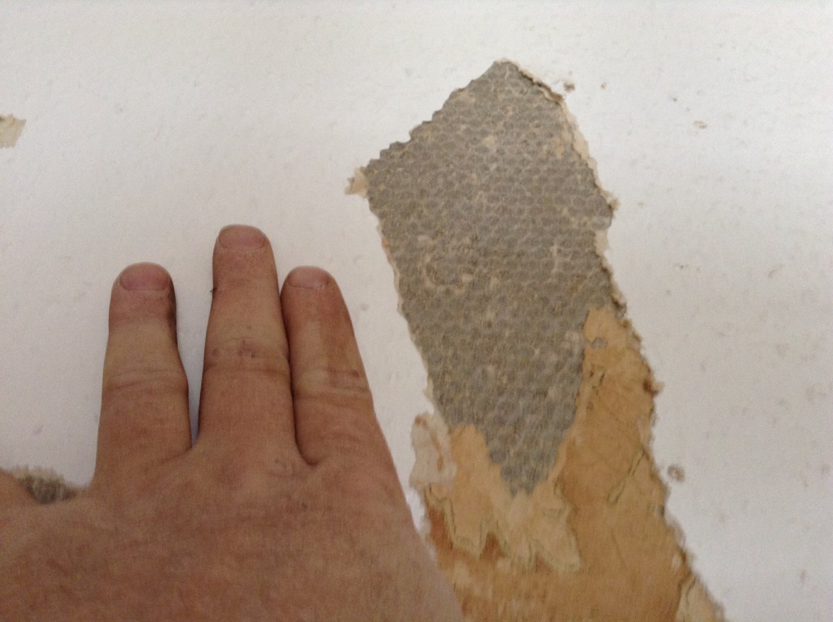

Can anyone confidently identify that material in the attached photo. I guess it is concrete board but obviously wonder about possibility of asbestos. Will get someone if there is any doubt
It looks like Asbestolex to me. If so the other side will have a smooth face. Don't scrape or sand it. Wipe up dust with a damp cloth and double-bag it in plastic.
You local council's website should have disposal information.
