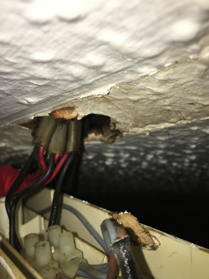

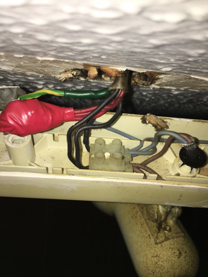

So I am replacing my kitchen light and I am faced with this!
What's going where here then? It's a late 70s house.
Thought it would an easy job but I'm confused! Any ideas?
Thanks a lot people
It's a standard wiring procedure.
The three red wires are lives, one coming in, one going out to the next fitting and one is to the light switch.
One black wire which is the return from the switch will be in the lights L terminal (it should have a red sleeve to identify that it is a live)
The remaining two black wires in the Neutral terminal will be the incoming Neutral and the outgoing Neutral to the next light.
It's exactly the same format as used with a 'Loop in Ceiling Rose'. Click here for a link to the Wiki which provides you with a diagram.
It's impossible to see from your photo, but the L and N connections at the light maybe reversed. I say that because the two Neutrals appear to be connected to brown wires at the fitting.

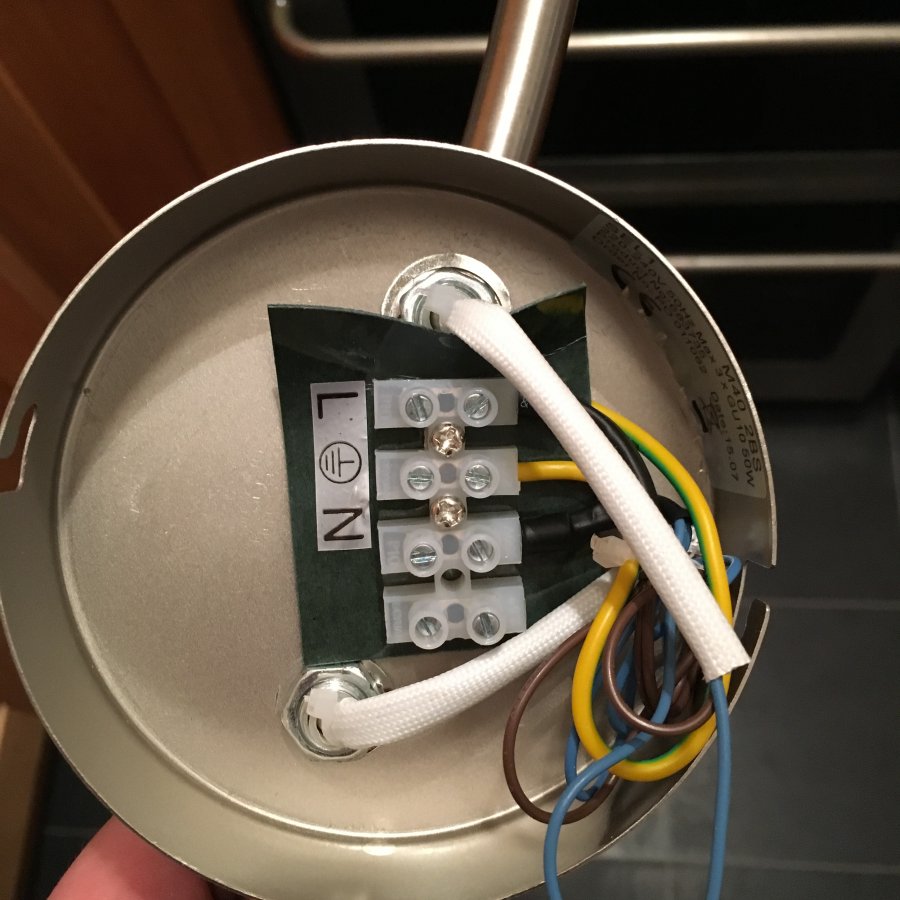

Thanks for your response it was very helpfull. The writing on the light is in English, the brown and grey is throwing me a bit though! The light that I am fitting is chrome. How would I earth it? Or is the not neccesary?
Thanks again
Yes, it's a little unusual. Germany used grey for neutral with brown or black for live at one time, hence my question. A check with a multimeter to the lampholders (which I assume are Edison Screw type) would confirm which is which, although as you're getting rid of that light fitting now it doesn't really matter.
Is there a marked earth terminal or a pigtail wire on the new fitting? It might be double-insulated, in which case no earth is needed. Picture?
So the single cable goes into the live, the other 2 would go into the neutral terminals? How would I earth? Sorry if I seem simple !
