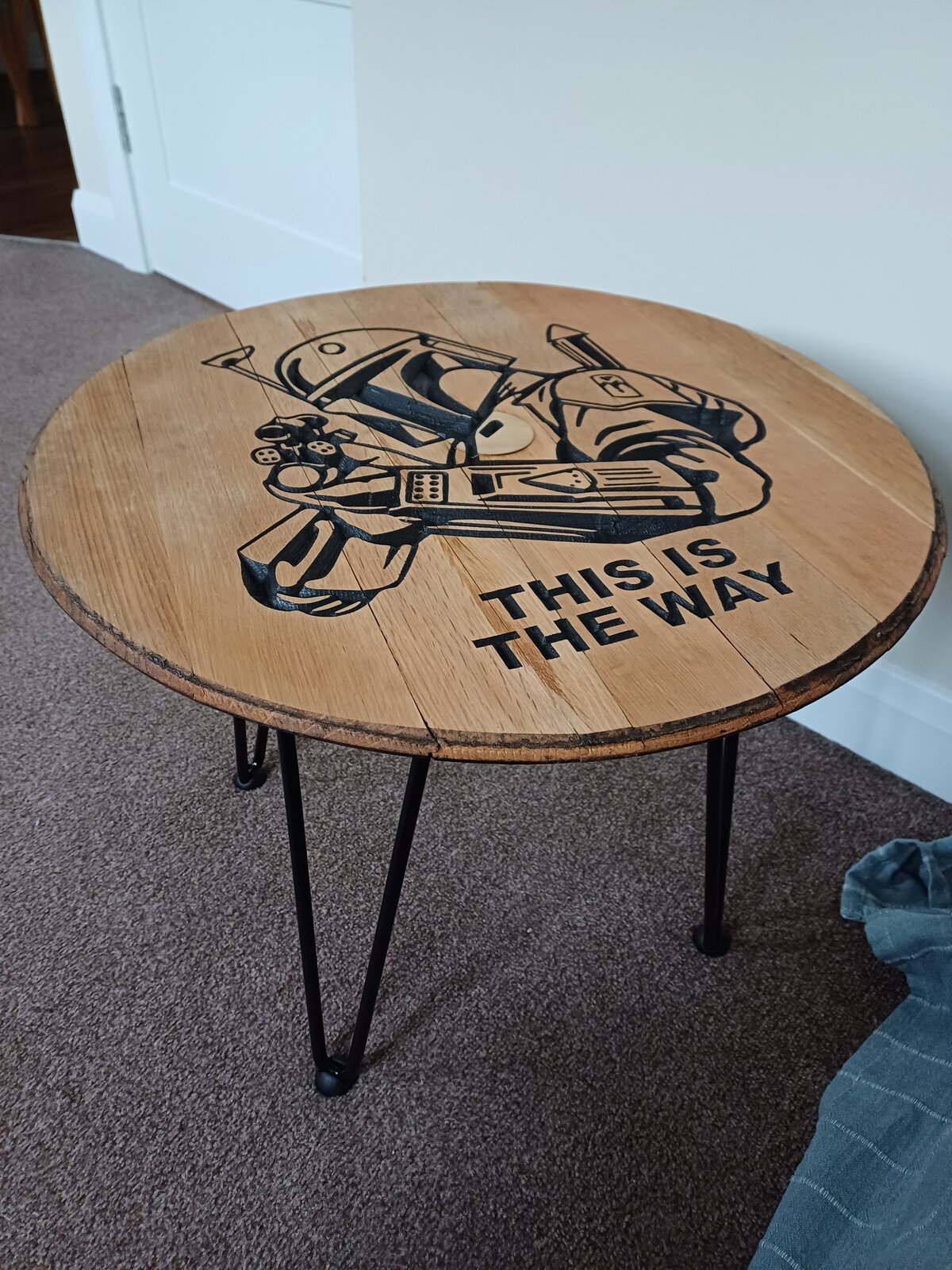

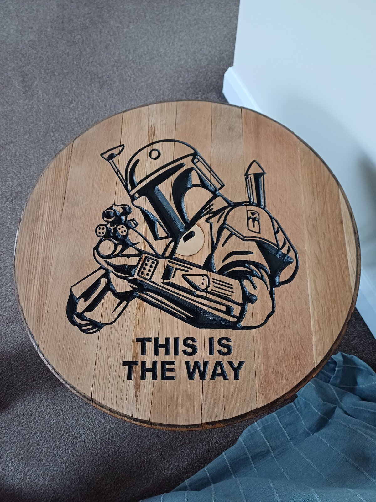

My son bought an engraved whisky barrel top, to which I attached hairpin legs. It looks great, but I don't know what to put on it to protect it. I'm not sure if it's got an existing protector on it and I want to keep the existing colour and matt finish. I'm also unsure about the engraved areas areas as I don't know what has been used to colour the black areas. Any suggestions?

its not fired [burned]its not aged at all its immensely smooth and not sure if barrels have txg planks on the lid
but having said that, it's an amazing looking thing
i assume routered though a jig or by CNC 'spray-painted black belt sanded and course sanding on the rim to leave some uneven black to look like age??
but purely a guess

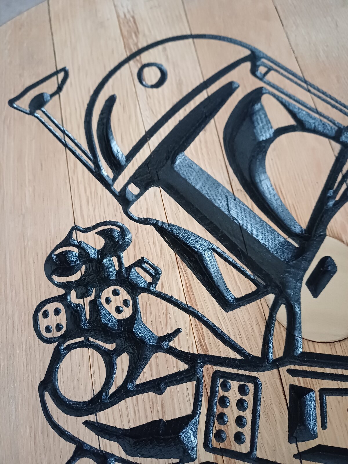

It looks like some kind of (3D) decal rather than being laser etched. Is it proud of the surface, or below the surface?
Perhaps wet your finger and see if the wood changes colour, if it doesn't, it has probably been sealed.
If it is raised, any glass will need something to lift it above the decal.

It's below the surface. No black colour comes of on the top but it does on the bottom side. Even the lightest touch results in black fingers. I should have sealed the bottom with something before attaching the legs ☹️

Cool. Perhaps consider something like osmo oil, or as @Wayners said, a waterbased varnish.
Osmo, use a lint free paper towel to apply it and simultaneously wipe away any excess. Soak the paper towel in water before disposing of it to reduce the risk of spontaneous combustion in the bin (or let it, the paper towel dry outdoors).
