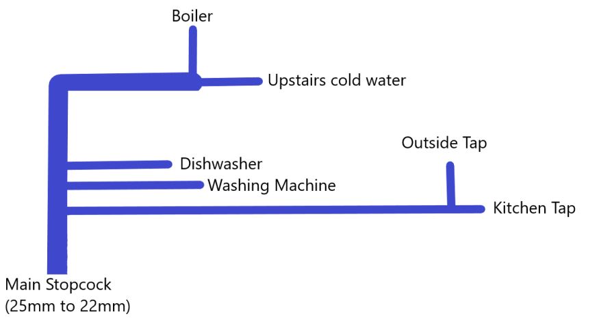

I stand corrected, it was 25mm MDPE in, not 28mm. I realised that once I looked at the original stopcock had 25 and 15 written on each side of it, referring to the pipe sizes. Don't know where I got the 28mm number from, before I actually checked.
Anyway I decided to proceed ahead and replace the 15mm copper pipe with 22mm copper pipe. Soldering was not to hard once I got the knack of it.
Now as below.

That would be more the preferred solution as far as the internal distribution pipework sizes and setting out would be concerned.
I have to ask though - what was the problem with the flow before all of this? Were there pressure and flow tests performed to allow a before and after comparison?
I'd hazard a guess that this was to improve the hot supply from the boiler as not first draw off and being robbed of flow by kitchen tap and appliances.
