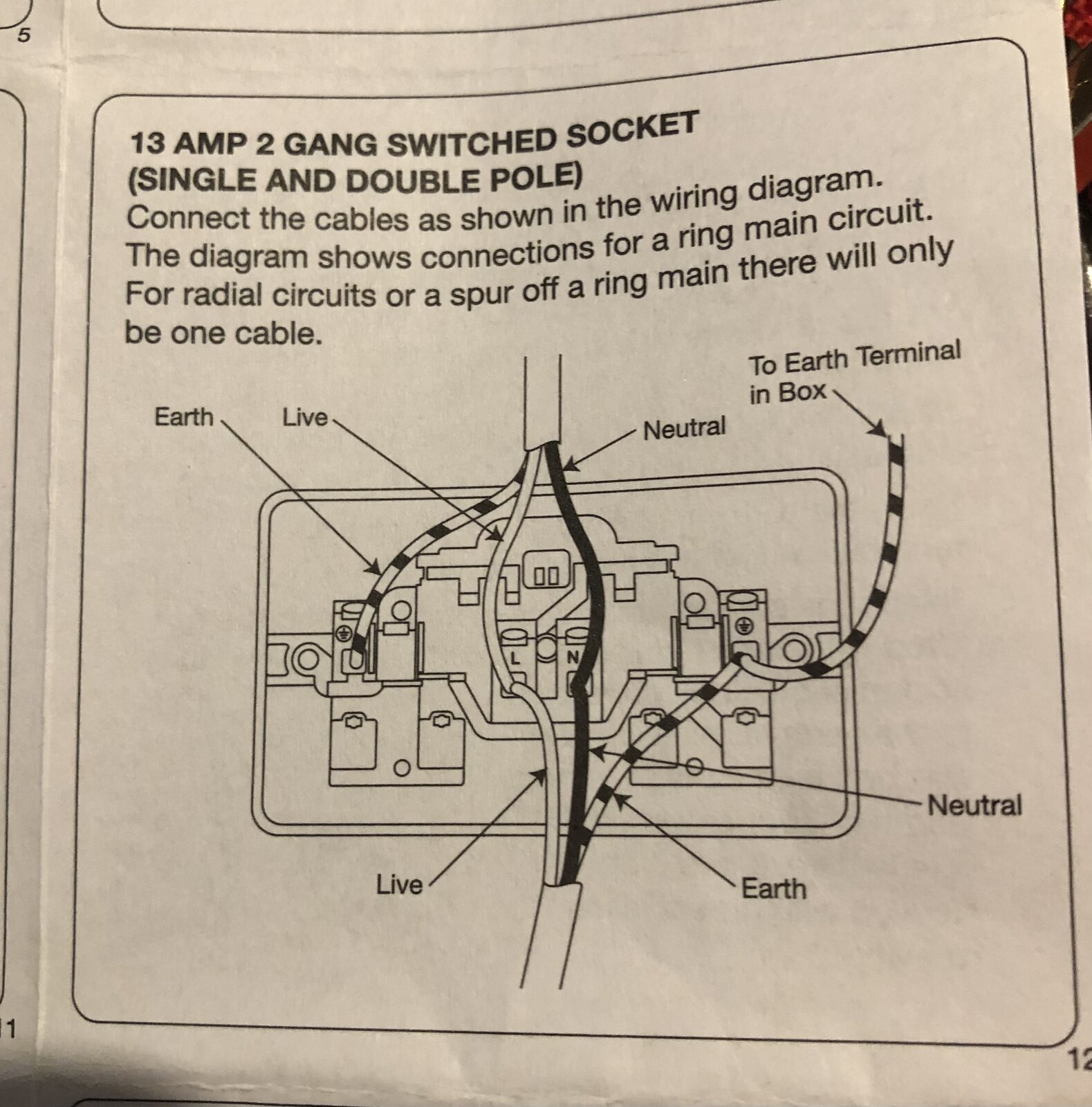

Hi,
I have taken out an old metal back box and replaced with a white plastic surface back box by Schneider electric. I have also purchased a new double switch plate and it clearly shows where to screw-in my live and neutral wiring. The two earthing wires each have their own interface and the diagram provided with the box shows to place one in each screwed slot. It also shows a single extra earth wire going from one earth slot to the earth terminal screw in the back box. There was no earth on the back box previously so I have purchased some wire to make this connection. The wire I have purchased from Screwfix is Time single core conduit cable 1.5 mm green/yellow. Will this be sufficient or do I need a more specialist wire?
Diagram I am following

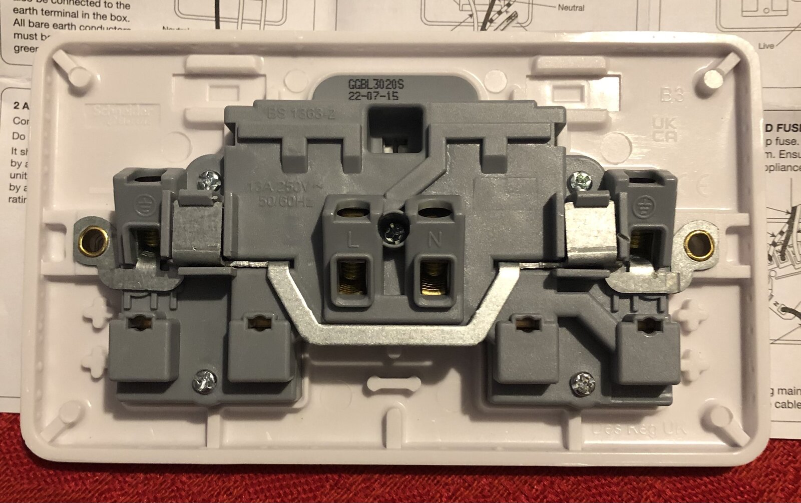

My new double socket switch plate also by Schneider…. Please note I am simply replacing an existing plastic plate which is now higher on the wall as the original
Socket was at ground level… not much use in a kitchen.

That diagram with the extra earth wire is referring to a metal back box like you removed. You just need to connect the earth wire from the supply cable to the socket earth terminal(s)

I had thought that plastic boxes did not need earthing however they provide a point for you to do so and I was okay with that.
The wire is ok, however plastic backboxes do not need an earth connection.

Thank you for your reply. I agree but the metal box which came out had nowhere for the wire yet the new plastic box does.
