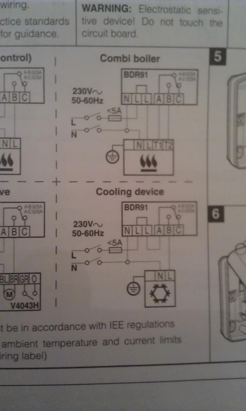

Hello
Has anyone got any experience wiring a honeywell cm927 to an ultracom combi boiler?
I am working with a registered boiler installer but we are both unsure as to how this should be wired, we have tried a few options but to no avail
would appreciate any help anyone might be able to give
thankyou
Connect BDR91 L and N to L and N in the boiler.
Remove link between 24v and 0 terminals
Connect A to the 24V terminal and B to 0
Do NOT link L to A
Many thanks D_Hailsham for your reply and very clear explanation, its much appreciated
But i am a little confused as i also contacted honeywell technical support with the same question and the response i got was as follows
N = Neutral
L = Live
A = OTC1
B = OTC2
is this incorrect then?

Yes; it's incorrect.
If you look at the Key in the top left corner of your first pic you will see that it says: OTC - Outdoor sensor connection. They are for use with a weather compensation system, which you don't have, that uses an external temperature sensor to control the temperature of the boiler.
Follow my wiring.
Hey D_Hailsham
I just wanted to say thankyou for your help, we followed your wiring and its all set up and working nicely
