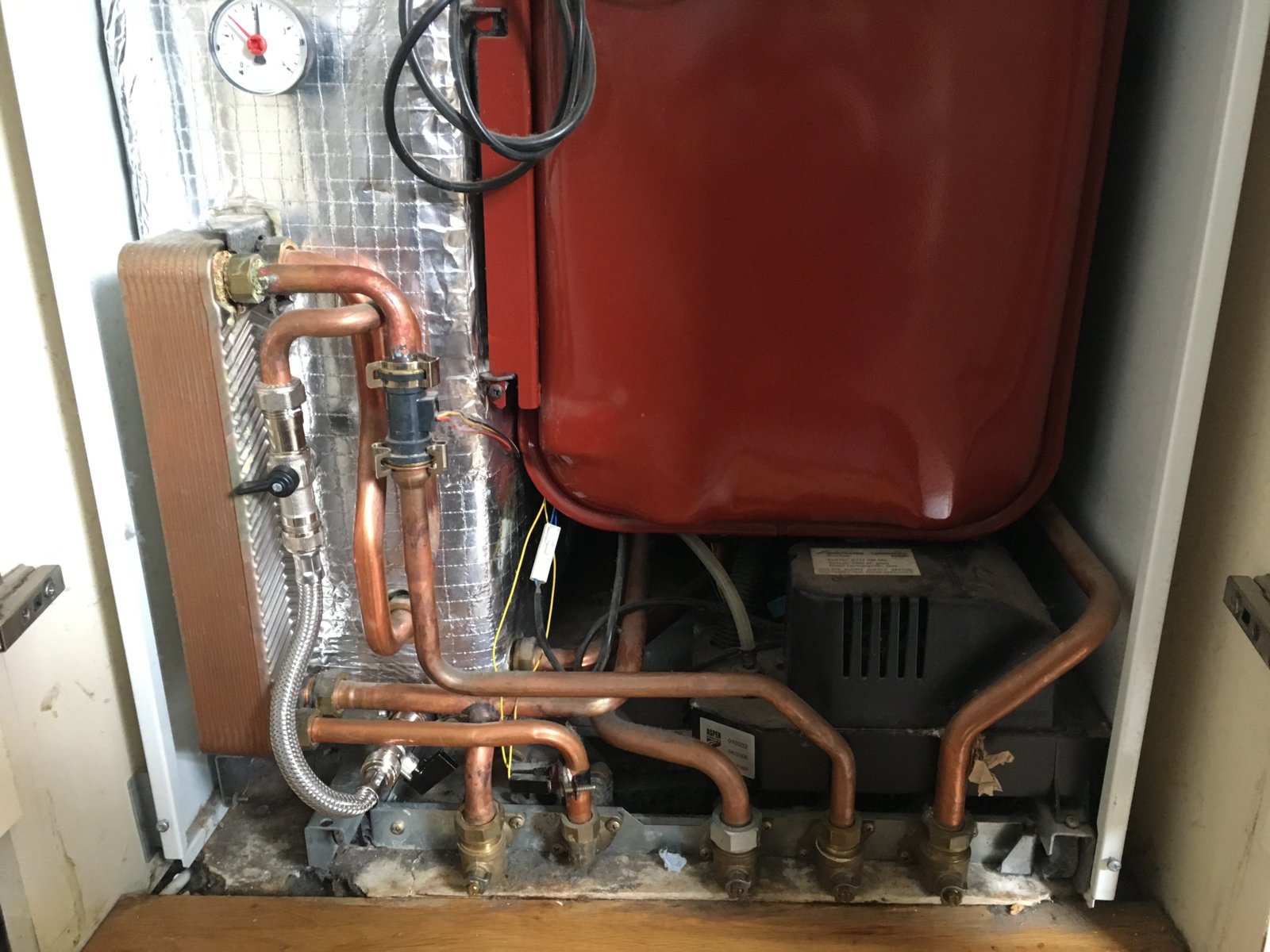

Check to see if the hot out pipe on the boiler becomes lukewarm when the shower is running, if it stays hot you could have the cold supply passing into the hot supply making the hot lukewarm, its normally a passing mixer tap or stuck non return valve in shower valves.
Thanks Picasso I'll do that. One thing I'd say is that the thermostatic mixer shower I have has a main cartridge and two separate pistons (a hot one and cold one). I've just replaced the hot one and the main cartridge as I thought that these were the problem. When you say cold could be passing into the hot supply could that be from a faulty cold water piston?
No if anything it will be a faulty/stuck hot nrv, check the boiler output first to rule it in or out.
There are various pipes that are hot - which one should I be concerned with?

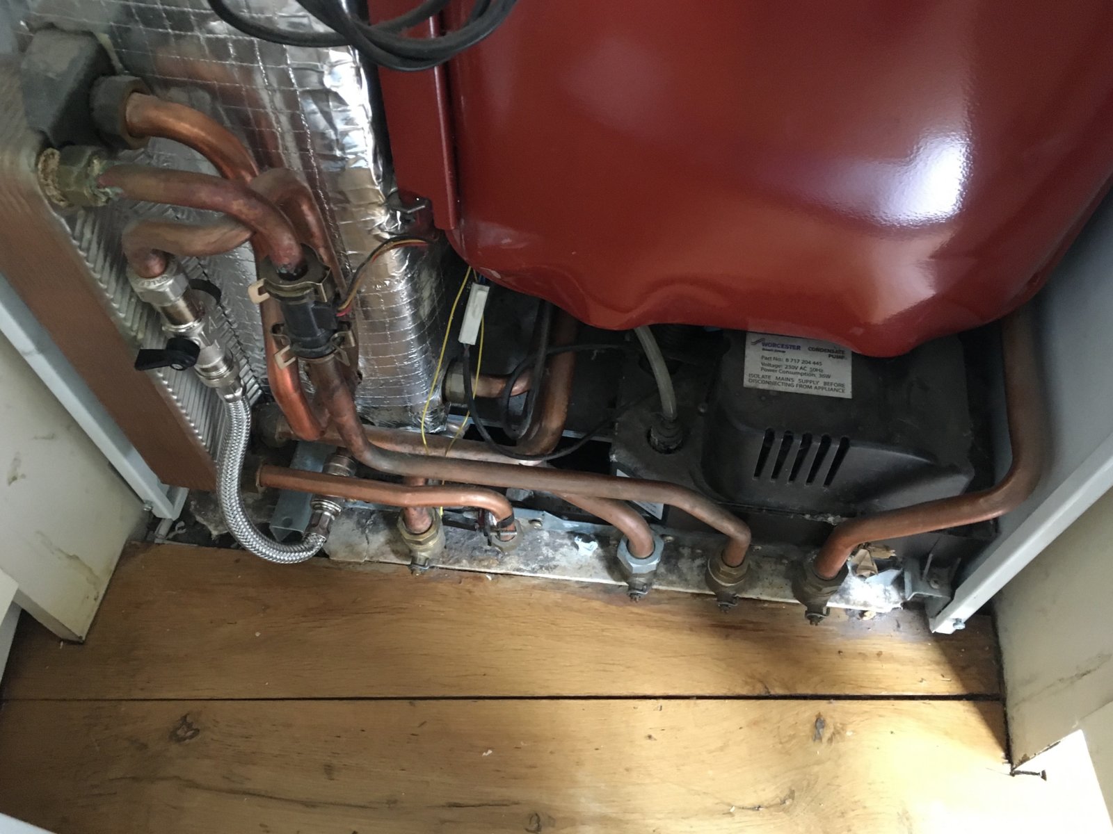

See attached photos below.
Also is the nrv part of the shower fitting? or is it part of the plumbing for the boiler?
Best
Mark

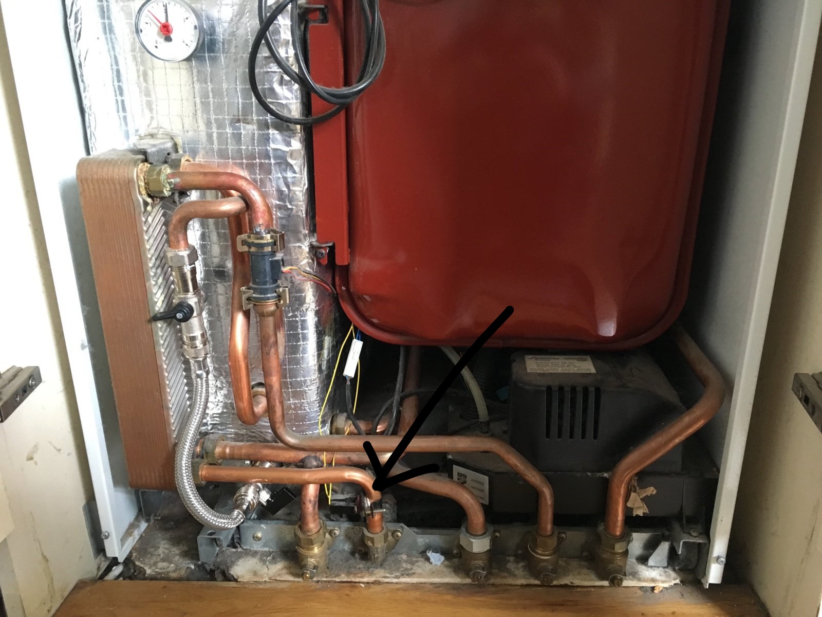

nrv is normally part of the shower (do you have more than one shower ?) the pipe I have marked should get hot and not fluctuate when a hot tap/shower is running.

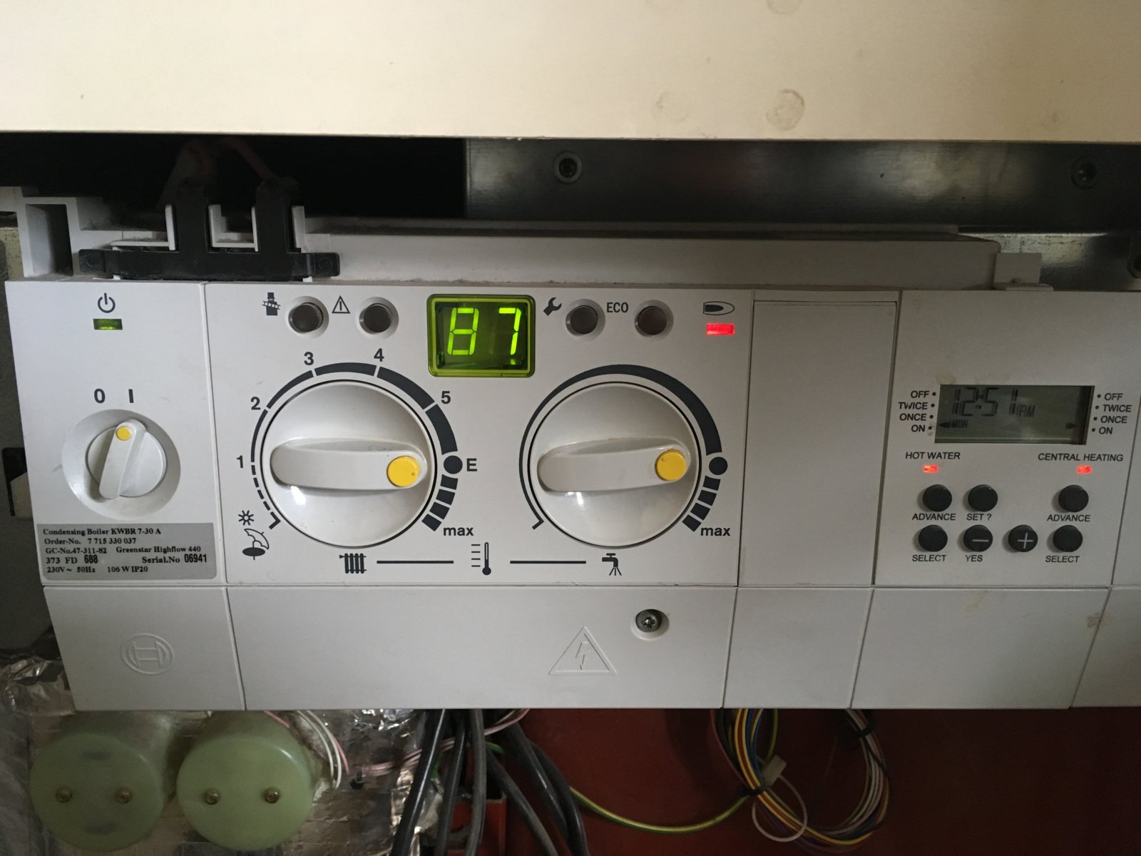

Your boiler is running rather hot (87c) seems likely your system is needing a clean.

So I've checked the tempo that pipe you highlighted and it was really hot when I switched the hot taps on but then after running them for 5 minutes the water temp dropped and the pipe temp also dropped.

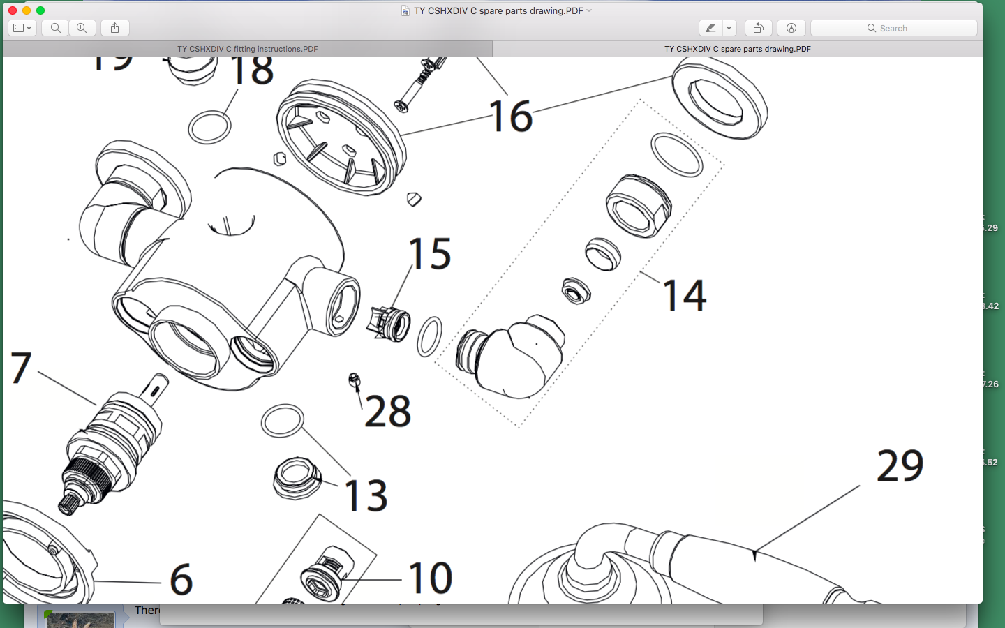

Bristan say the nrvs are in the elbows of my mixer shower. Is it a big job to get at these and replace them?
Mark
If the pipe I highlighted went lukewarm then you have a boiler problem.
So part 15 on this diagram is the nrv. it has a grub screw holding the elbow in pace. If I isolate the mains do you think it would be as easy as taking the grub out and removing the nrv or will the whole shower mixer have to be disassembled to get at the nrv?
