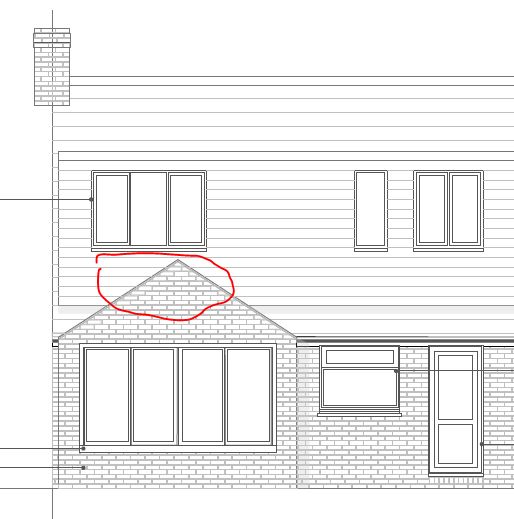

Rear extension on bungalow
meets proposed new dormer. Any reason why this could fail PD or all good?
First of all, are you talking Planning Department or Permitted Development?
If you are talking Permitted development, you first have to make sure you have it. If you don't, then you will certainly have to go through Planning Department, and probably Building Control for permission before even digging the first sod of earth.
If you are talking Planning Department, you will need to contact them as they will be the ones making the decision.
Fails due to the connection.

Why? Are you saying the extension roof volume will be added to the dormer volume? If so how do you know it exceeds the total volume allowance. Also is the new dormer being done under permitted development?
I can't find it at the moment but I'm sure I've got something here that says a roof enlargement (dormer) volume calculation should only include the original roof and an extension roof that connects to the main roof should not be added to the "enlargement by additions to the roof" volume calculation.

Hi think after doing a bit further research is that if you link the extension and the dormer it fails as they will technically regard it as a two storey extension. I think.

It's the dormer connection to that gabled roof - the dormer no longer meets the set back from eaves requirement for PD.

It looks like a single storey extension to me.

I doubt that anyone is going to seriously class what's proposed here as anything other than single storey.
I'm happy to be proved wrong but I do not think that is correct.
Whilst a single storey extension joined to a two storey extension can be a problem a dormer is not an extension - it is a roof enlargement which is a different class and subject to different rules. In my opinion the dormer and ground floor extension should be assessed under the separate relevant criteria for a single storey extension and a separate roof enlargement. Obviously if the loft conversion extended into the extension roof it would be a different matter but that is not the case here.
