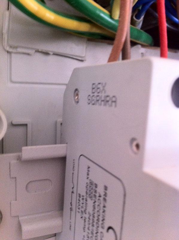

Anyway, in amongst my reading, I came upon something else that might be of interest to me. The house I am in was extended (virtually rebuilt) before I bought it. It has a Wylex CU and the "last test date" on a sticker on it says October 2009. I assume that is when it was installed, though it could have been done over a period of time and that may be when it was finally completed. I believe some Wylex MCBs were recalled and my board has some of the affected sizes present. Is there a way to know whether they are indeed affected or whether they could have been replaced already? Will my electrician be able to tell? Will Wylex pay for him to replace them?

I posted this in Electrical Safety and it contains the codes you need to look for:

Thanks. I definitely have some 6/16 breakers and those codes look like the info I need. Guess I'll have to open the CU and might have to take them out to get a look at the side of them.

I presume the "side" of the MCB is not visible when the MCB is installed in the consumer unit, so you would have to remove it to check.
That's what I thought too, as it's not obvious from the front and most of them are sandwiched between others.
Will let you know when I get chance to look during daylight hours, so I can see with the power off - don't want to do it by torchlight alone and would rather turn it off before opening it (there is an isolator switch on the cutout).

I was highlighting the fact that the codes mentioned are only the last 4 characters of the code on the MCB.
So, when you see the MCB, it'll have more than 4 char's printed on it. You're looking specifically at the last 4.
OK Here is the board:
And here is the side of one of the 6A MCB's:
So, RHRA - looks like I need them replaced. Should I phone the number on the recall and let them deal with it, or should I contact my electrician and have him deal with it? I'd rather use an electrician I chose if they'll allow that.

Please read the next to last paragraph on the recall notice. You need to find a competent electrician and he will sort it out directly with Electrium.
They will not deal with you re this.
