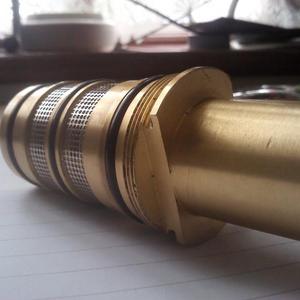

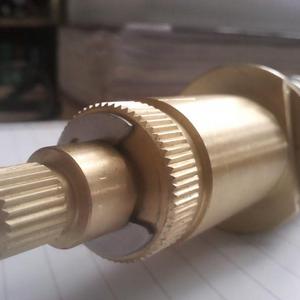

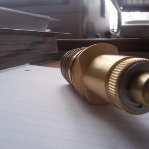

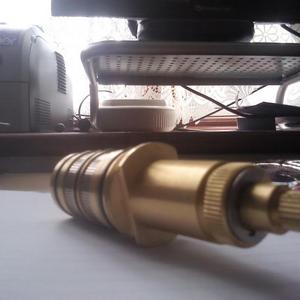

    help with removing thermostatic shower cartridge
    Thanks for those suggestions John + Andytw. Am going to head on over to toolstation and see if I can find a box spanner that fits, or a close fit which I can cut/modify. I will also get a small section of pipe that fits and see if I can get a metalworks to 'make' a two pronged tool. Im...
  2. A
    Hey John, Yes, unfortunately it is very deeply recessed! Not a chance to get anything remotely close to it. Its gonna be some kind of long, hollow, cylindrical tube with appropriate 'gripping points' on the end. Amjag
  3. A
    Hey, My thermostatic cartridge has malfunctioned and I am trying to replace it. I have a replacement to hand but am having difficulty removing the old one. I have attached pictures to show the long spindle/shaft along with the 'bit' that grips onto some tool allowing me to twist it off...
