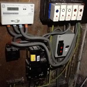

  3. Main board
    Main board
    Pics

    Mursal, thanks for reply. But i dont have a circuit breaker on the shower it is a cartridge based fuse enclosed in an old ceramic type holder.

    Thanks for the quick replies. 10mm is the measurement across the cable, i cant see any writing on the visible part of the cable. The cable runs from the shower into the loft across the house then down to the the main board, i would estimate about 17m? The cable runs through the wall cavity.

    Replacing a shower
    Hi folks, In need of some advice, prior to replacing my shower. The unit that i have bought is 9.5kw. However, having read and calculated fuse requirements, i think i might be under fused. To give you some particulars, the shower cable is 10 mm, i cannot establish what rating (kw) the...
