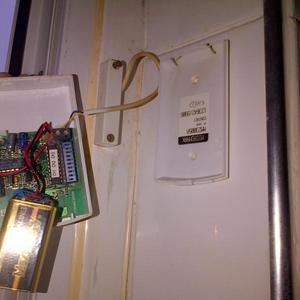

    Well, funny you should say that it looks like its been in the shed. When I opened the battery box, written in biro is the word 'Shed'! Anyway, to say the screws look old is putting it mildly, the are practically falling out. I tried tapping the contact, but no alarm went off - I think I tapped...

    Well, im sure that we had it working when we first moved in and it showed that it was zone 4 that was lit up. When we press the panic button, its zone 4 that lights up. While i am no expert at all, does it seem like it is the door contacts that are faulty?? Appreciate all the replys...

    Here are the pictures, thanx for the reply, john

    Hi, Hope this is posted in the right place and that someone can help with a problem that I am having with my Accenta alarm system. Basically, we have just moved into a new house with one of these systems already installed (The system has Accenta written on it, however, there is none of the...
