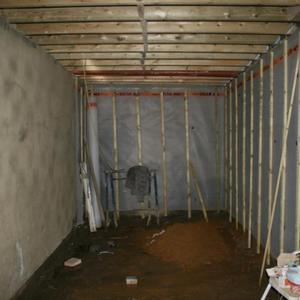

    Basement Water Penetration
    Hi, Thanks for thge responses, much appreciated and insigthful. Here are some photos. Letters A and B shows where water has seaped behind the membrane down to the ground. At point A in the ground, a little digging showed quite a bit of water in the ground. Letter C shows exactly the point...
  9. Untitled
    Towards right side of the basement.
  10. Untitled
    Entrance from the garden.
  11. Untitled
    Water is appearing through the wall behind the membrane at point C.
  12. Untitled
    Water is appearing through the ground at point A, when dug a little.
  13. Basement
    Basement
    Basement photos with Delta membrane.
