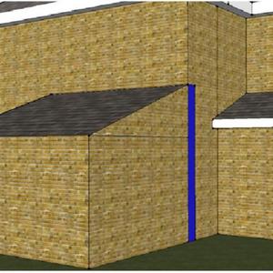

    Joining an extension to a leaning wall?
    I would be very grateful for some expert advice on how to join the wall of a new lean-to extension to an existing cavity wall which is out of plumb by about 18mm over 3m height. (blue line on pic) My SE thinks the house settled soon after being built in the 50s. It is not showing any signs...
