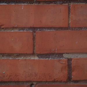

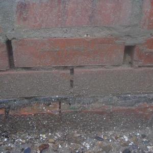

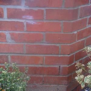

    Confusing pointing problem - Pictures Added
    As promised, some piccies: A wider view showing the cement pointing only down to a certain level, the remnants of the concrete that breached the DPC and the slate DPC at the bottom. There is only one course of bricks below the ground level and no foundations that I can find. A...
    Sorry about the delay replying - my notifications didn't work properly. It is definitely cavity construction and there is definitely a layer of slate 2 courses up in the the wall. The date is taken from a stone set into the front of the house, so I'm assuming that's correct too. The inner...
    I've got a bit of a problem with my pointing (I think). House is 1889 3 bed semi of cavity wall construction. I've had some damp problems in the front bay window in the past, mainly caused by dodgy guttering and a concrete pad outside that breached the old slate DPC. I've removed the...
