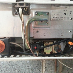

    Thanks all - I did figure out eventually that the auto air release (?) was another valve that could be bled. I found that with the heating on, I could open this and air would hiss out for say 20 seconds, then I'd close it for a minute and then reopen it and it would let more air out. I...

    Think I spoke too soon. The boiler did fire up but has gone off again much too soon (and the radiators are not warm. The thermostat's still on max. I tried bleeding the pump again and giving it some gentle taps but that doesn't seem to be the problem. There is some other device to the right...

    I had not bled the pump. Have now though and it required several minutes bleeding too! The boiler has fired up now so I think you have solved my problem. Thanks very much! Now back to checking for leaks in my pipework...

    Er - no I'm not sure actually. I didn't hear it start but I suppose it might have. I've attached a picture of my boiler:

    Hi all, Firstly, I have an old Baxi (non-combi) system. I am refitting a bathroom. In preparation for the later fitting of a new towel rail / radiator, I have drained down the central heating system. I've now fitted all the new pipework and fitted valves to the end of the new radiator feed...
