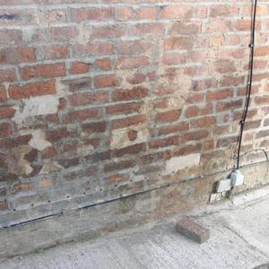

    How would I go about getting rid of the hydroscopic salts from the bricks if it was this?

    I just had a look at the driveway and just where the air brick in the photo is, there is a different patch of concrete which actually slopes to the house, which I suspect may cause puddling of water (but I have never really noticed) - i'll check next time it rains (probably tonight!! :D )...

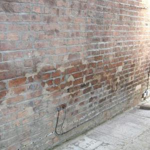

    The inside floor is suspended floor boards, the low vent is venting the cellar. The dpc was done because of signs of damp inside the house. I'll have to check the dpc level inside, but I believe the dpc level outside is the equivelent of about 2 bricks height inside the house. The bricks...

    It's a solid brick wall, circa 1880's terrace, so no cavity.

    Its my driveway, so no drunken p***ing up the wall I hope!! :lol: It doesn't have any type of cowl on the chimey, do you think it could be too much rain getting in from there? It has three large chimney pots on top, so there is plenty of room for rain to get down I guess. But wouldn't that...

    Hi guys, I have a damp problem which has been totally baffling me for a while and would appreciate some help. Basically I have a damp patch at the bottom of the gable wall of my end terrace house, and I just can't work out where it is coming from. (See pictures). A little bit of...
