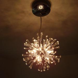

    Advice required re: newly installed chandelier
    Hi all, Thanks so much for your help. I thought you might be interested to know the latest. I managed to track down and contact the manufacturer of the chandelier and they recommended a C10 breaker. They also said in order to dim the light I should use a dimmer switch suitable for low...

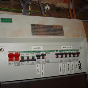

    Hi JohnD, Sorry, read your previous post quickly and obviously not properly :oops: . The consumer unit is a CrabTree StarBreaker. You can see from the pic the switch labelled "All Lights" is for the upstairs and downstairs lights. I forgot to mention before, there is a seperate circuit...

  6. K
    Hi, What a nice forum ... everyone has been so helpful and I am definitely starting to learn something about electrics!. In response to JohnD... I bought the 15 light pendant chandelier from John Lewis a month or so ago in the sale, but is it now discontinued. It is called "Snezka"...

  10. K
    Hiya, The Kitchen light is on the same MCB as the chandelier. Here are all of the details in the "LIGHTS" row of the old Kitchen Part P certificate ... Type of wiring = A Number of points served = 11 Circuit conductors (csa): Live mm sq. = 1.5 cpc mm sq. = 1 Max. disconnection...
  11. K
    Hiya, I don't know if this helps at all ... but I just found another part P of some work I had done on the kitchen ages ago and those electricians tested the lighting circuit and put down a "Maximum measured earth fault loop impedence" of 0.91 ohms down. Since the kitchen I have had...
