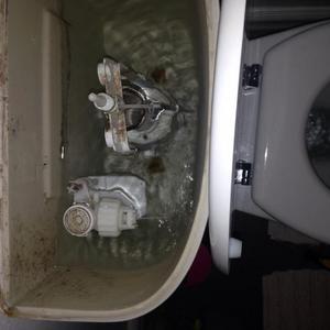

    Toilet overflowing
    I just bought the fluid master having difficulties unscrewing the metal bolt under the bowl what type of pliers do you recommend ?

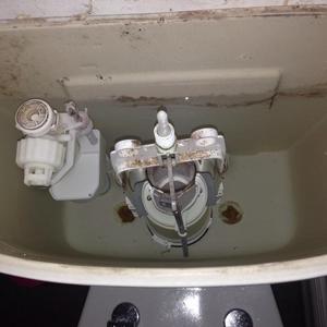

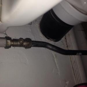

    Toilet overflowing
    Here are the pics. I followed all instructions carefully but to no avail. Do you mean I should buy a new washer or a complete injet system ? Incoming water pipe is at the bottom, and I don't think there is a tank at the loft

  9. M
    Toilet overflowing
    Please help for some reasons I'm doing something wrong, the toilet is overflowing into the tube as the water is not shutting off. I have replaced the washer in the injet valve but it's still not shutting down, when I manually raise the ball the water still doesn't shut down, water still splashes...
