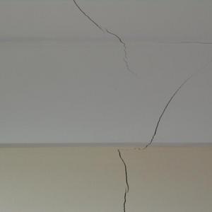

    The plans do not have movement or expansion joints marked. But on the right hand side of the A3 sheet there is a column titled 'General Specification', and half way down is the following printed: Movement Joints Provide movement joint in lightweight blockwork @ 6m centres max. Joints to...

    Thank you for the replies so far. Just to be clear the outside brick wall is split into 2 walls by the brown mastic joint so there are kind of 2 x 5.5m walls if that makes sence.?
  11. N
    Cracks in wall - can I repair these myself?
    2 1/2 years ago we had a 11m x 2m singe story extension built, but around a year ago I noticed a vertical crack and now there are 2 cracks. The widest is 2m from one end of the extension wall and the lesser crack is 3m from the other end. The extension is split into 2 rooms - 9m x 2m + 2m x 2m...
