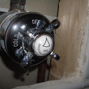

    Removing cover from a Bristan SINGLE CONTROL shower mixer
    Several hours after your reply, Bristan did indeed email a scan of the original fitting / maintenance instructions. We are suffering from the problem that the original installer didn't leave the instructions and the paperwork we do have doesn't include any product ID. That installer also...
  5. P
    Thanks for that. The grub screw is a very small hex socket head. It was obscured by sealant. As it is right back at the rear end of the whole cover, it had been built into the wall (as you can see from the picture, I've had to remove tile & dry wall). Presumably the installation instructions...
  6. P
    Sorry, should have said - yes, I have removed the cross head with no problem. I left it on in the photo to help with identification. Am I really the only person with one (actually two) of these? Most enquiries on this forum are about seized cartridges - I'll worry about that when I have...
  7. P
    Hello, I'm trying to change the seals of a recessed Bristan 1901 shower mixer. This is a SINGLE CONTROL version, installed in 2000. Bristan now only make a 2 control version, which has a flow control lever. Mine has just the one knob for heat control - behind this is a chrome cover which...
