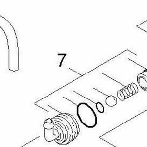

    Karcher - Problem with Detergent Suction connection
    Update: Before attempting to remove the metal plate which would give me access to the detergent ftg assembly I decided to experiment ... Power off + mains water on = water pours from detergent ftg nipple. Power off + mains pressure + pull trigger = water stops leaking from detergent ftg...
    Brilliant! The diagram really helped It appears that the plastic tube simply slips over the nipple. What looks like a ball & spring assembly within the 'detergent fitting assembly' (#7 in diag.) is probably the culprit as it's likely to perform a non-return function I'd guess. I...
    I have a KB3030 model and somehow managed to disconnect the detergent suction hose. :oops: The machine started passing water internally and when I opened up the casing and connected it to a water supply the water was pouring from the end of the connection that the detergent suction hose...
