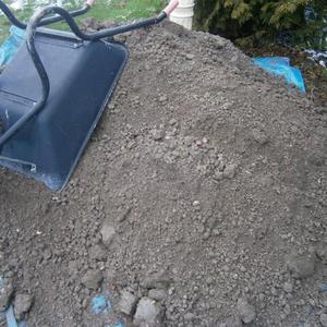

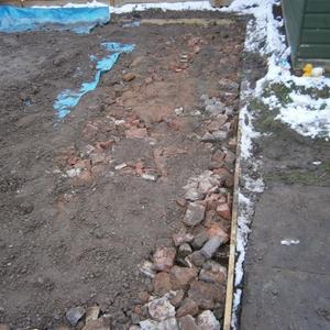

    Thanks for your all your comments; the house bricks and other rubble is coming up too then. Would the pile of busted up concrete from the original base be ok to use as a sub-base? And would I need to rent in a whacker to get it compacted down?

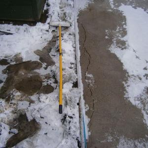

    Update: Contractor came out. He said the concrete had not gone off properly. He suggested cutting out blocks of concrete where the cracks were and filling in with a new mix. Pic of one crack: I declined and said I wanted it up and relaid by someone else. We came to an amicable...

    Yes, I thought it was too little cement. Don't suppose there's any way of knowing after two days if the mix is lean or not? I asked if it should be covered before he left, but he said no it would only sweat. The contractor started job Thursday morning too, and as I said I did raise concerns...

    Hello all, Great forum - hoping someone can kindly provide some advice for me. Basically, I’m wondering if it’s possible to tell if a concrete base is going to be good or not after just a few days? Below is the story so far: I've just had a contractor lay a concrete base 4x5 m 100 mm...
