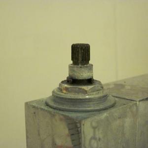

    Ceramic Valve ID help
    Yes - very similar except that mine has a shower attachment as well - but otherwise identical. Any info on the make or where I could get the valves would be a life saver. Girlfriend on my case to get it fixed and tap location is difficult to change

    Thanks for the help. Here are a couple of pictures of the whole valve unit. I'll send it to Lunns as well to see if they have any clues.
  5. Ceramic Valve 3
    Ceramic Valve 3
  6. Ceramic Valve 2
    Ceramic Valve 2

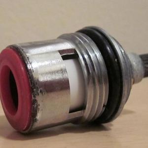

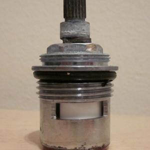

    I have a leaky bath tap which was bought from the bathstore about 3 years ago. Unfortunately can't remember the name or any details of the manufacturer so wonder if anyone on here could help identify the ceramic valve so I can get it replaced. I've counted and it is an 18 spline valve but looked...
  8. Ceramic Valve
    Ceramic Valve
    Can anyone ID this valve please?
