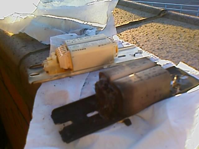

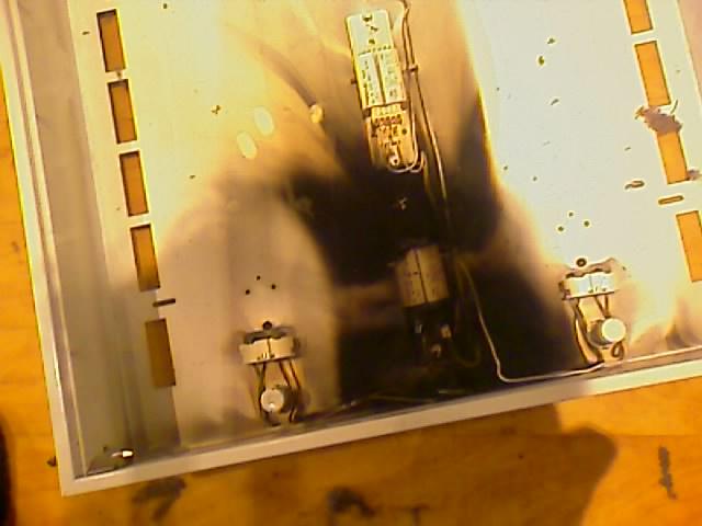

Going off on a tangent for a minuite what happens if the ballest on a flourescent lamp fails short such that full mains voltage is applied to the tube? How much current is drawn? is it in a range where normal circuit protection would be expected to operate?
I find most chokes and electronic ballasts seem to fail to earth so the current usually reaches a peak till the circuit disconnects or the fault blows clear.
We proberly get at least one a week fail this way and usually take a 6A or 10A circuit out
Only occasionally have i found fault current actually goes to the lamp, the filament goes excessively bright then blows clear usually leaving a couple of inches inside of the glass clear, the lamp never works again, i dont think the current flowing is that extreme when it happens before the filament fails.
I have put lamps in and seen this happen and dont recall it ever taking out the mcb
