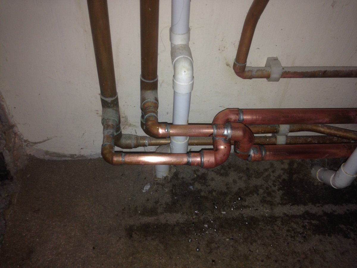

Hi all
I had a plumber in today to run the flow/return to my two manifolds. One for UFH, and the other for upstairs rads.
When we had the boiler installed a few months back, the original plumber left a couple of tails to run to the UFH manifold which I told him I was installing later. For some reason he put in 15mm tails.
Now, the plumber I've had in today has left those in and run 22mm pipe from them. Can someone advise as to whether this is going to reduce the flow? In my mind it will, but I'm not a plumber, and would like to get some advise before calling him back.
Thanks!

Common sense says that 15mm in a 22mm run will reduce the flow, but without knowing the complete setup, it's difficult to at definitely yes or know.
That was lazy work. I assume he had to drain the system down to add the new pipe. It would have been easy to heat the 22mm to 15 reducer, and remove it, then carry on with 22mm, and the job would have been even easier, and much neater.

System is 4xUFH loops, total of 55sqm a towel rail and twin rad from one manifold, and 4x rads off the second manifold. So the flow/return has to service all of this.

Sorry, but that's rubbish. He can run the RH down pipe behind the plastic pipe, and the LH down pipe will go in front. He needs to heat the old joints and turn them at the same time so that they loosen, and he can then wiggle the joinst apart. He then needs to clean the old pipework up, make up the new pipework, and use a slip joint to get on to the 22mm pipe he's just installed. If he uses heat barrier spray (Cool Gel), and a heat mat, he can then protect the wall and everything around it.

The boss has been in himself and resolved the 15mm pipe issue, and added a couple of drains that were missing also. Still waiting for the bill. Will see what that comes to!
Having a short length down at 15mm isn't going to be a huge restriction - the speed of the water increases through the 'restriction' then slows down again when back at 22mm. The reduced pipe size does present more pressure loss per metre.... but not enough to get a hard on about.
