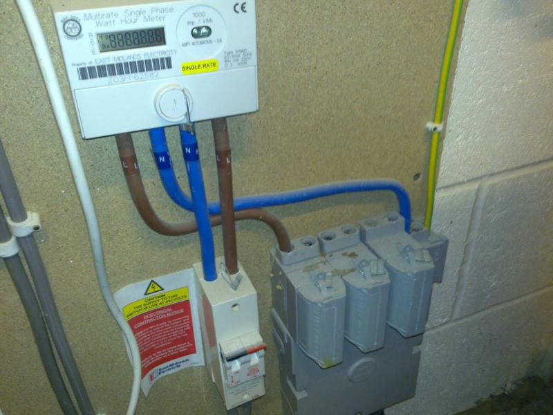

Can anyone let me know what the best way of going about installing a 3 phase supply to my lock up, i've included a photo of the main incoming supply as it is, but as this is only single phase will i need to contact my local electric supplier or can an electrician tap off what is already there?
You need to conact your supplier to get a three phase meter installed.
  • Thanks
Reactions: CBW
Is it definately three phase to the service head or just single phase and the DNO installed a three phase head?
If it's the latter then it will cost alot more. :cry:
