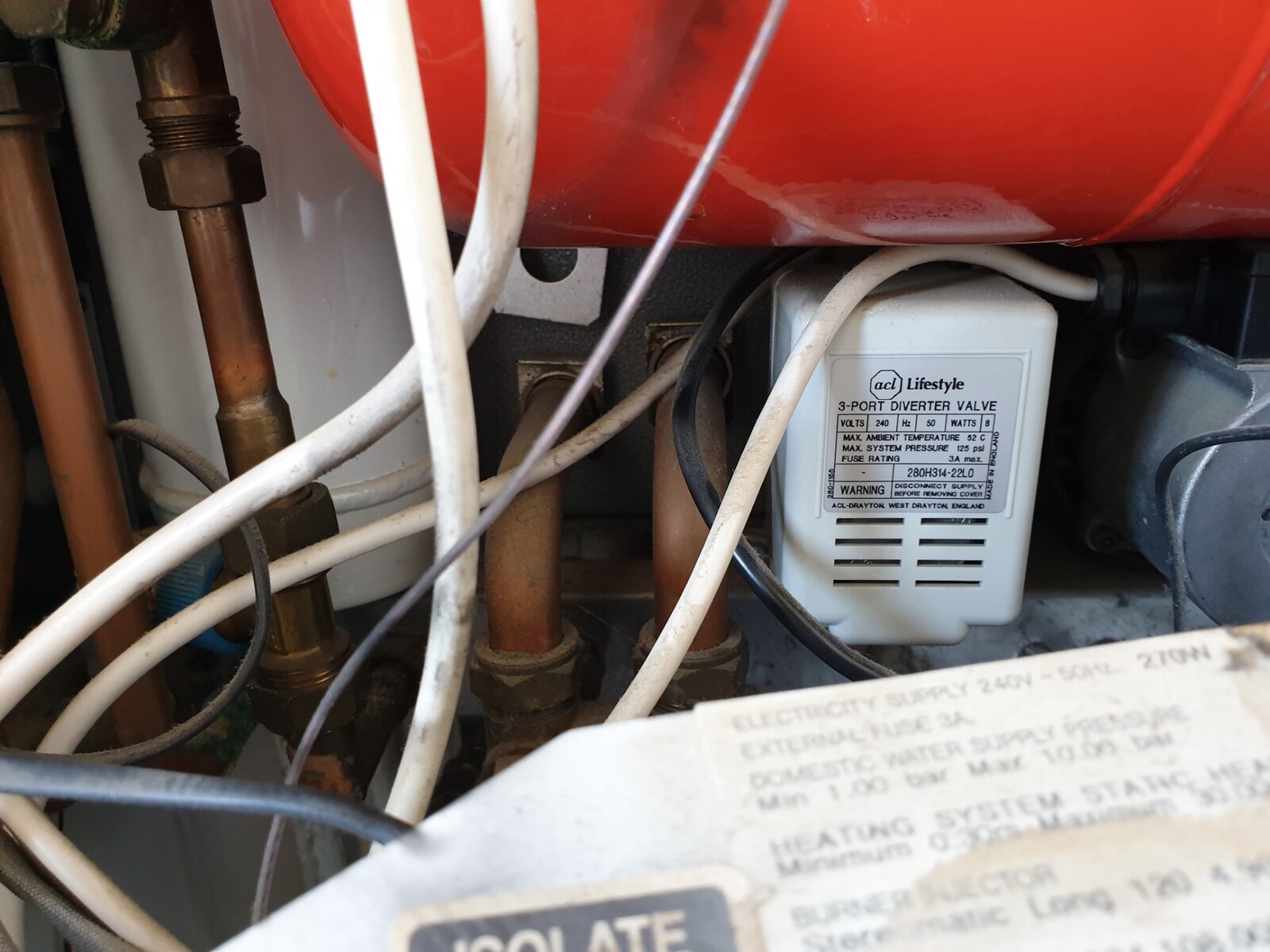

Does anyone know where I can obtain a new or refurbished acl lifestyle 3-port diverter valve 280h314-22lo please?
any ACL 22mm mid position valve will fit, dont call it a diverter valve that is a different thing
But is says diverter valve on the body! (see pic). Any response?

you never said it was a boiler internal unit, you will have to order the one specific for your boiler

Can you give me a website reference, please? I can't find one anywhere neither can 2 gas engineers here!

What exactly has failed on your valve? If it is the same as the early Worcs oil combis, then the synchron motor is the only moving part. If the springs have come loose off the base of the actuator, these can be replaced with small self tappers.
