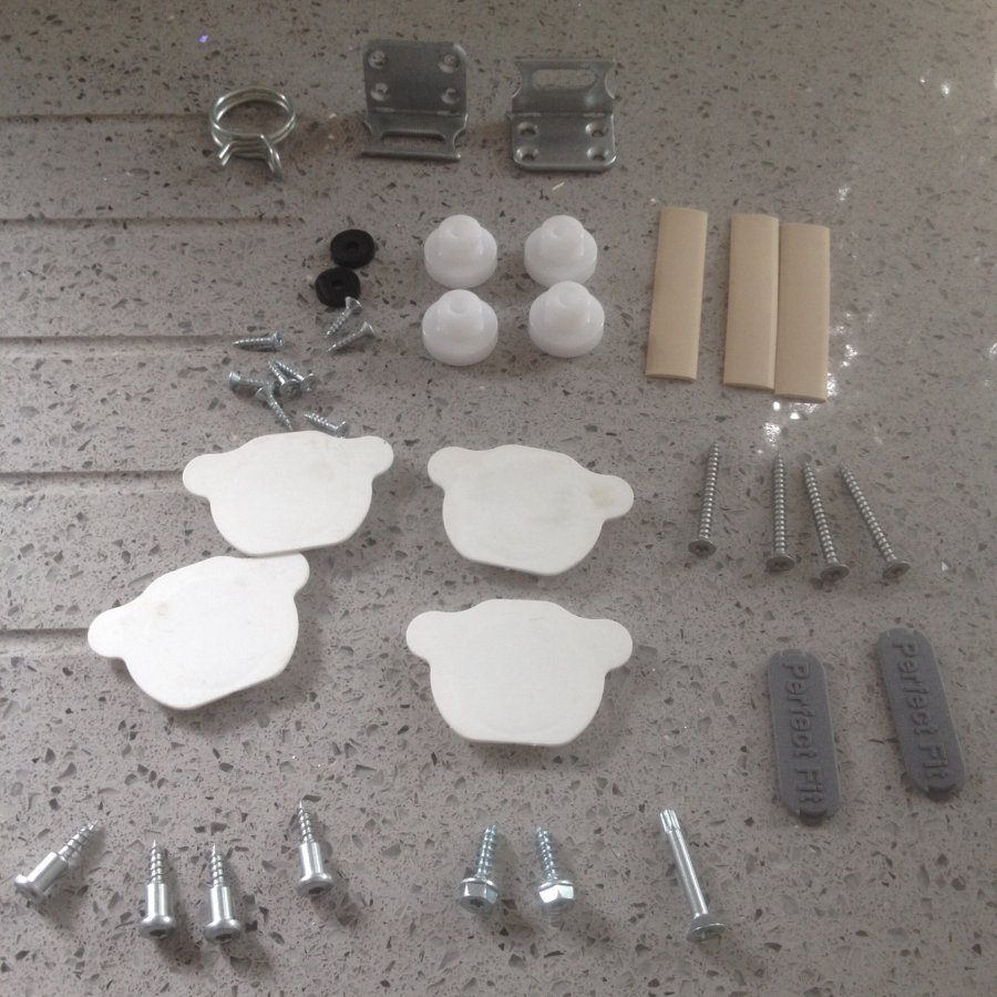

We have an IKEA one, with bits and pieces which DO NOT include any type of sliding hinge. There are some plastic and metal nut type things which look as if they would slide in grooves on the front of the washer.
There are also long screws which would hold the panel in place.

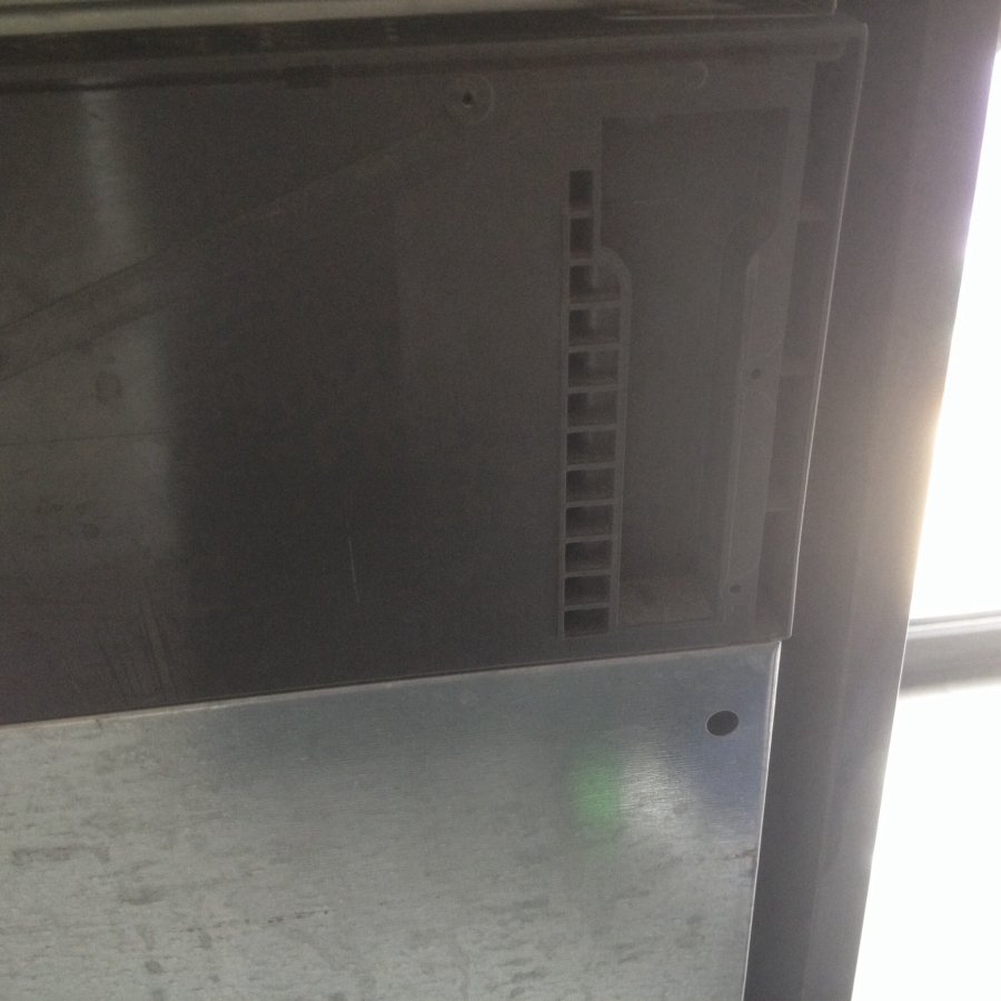

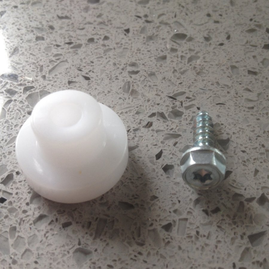

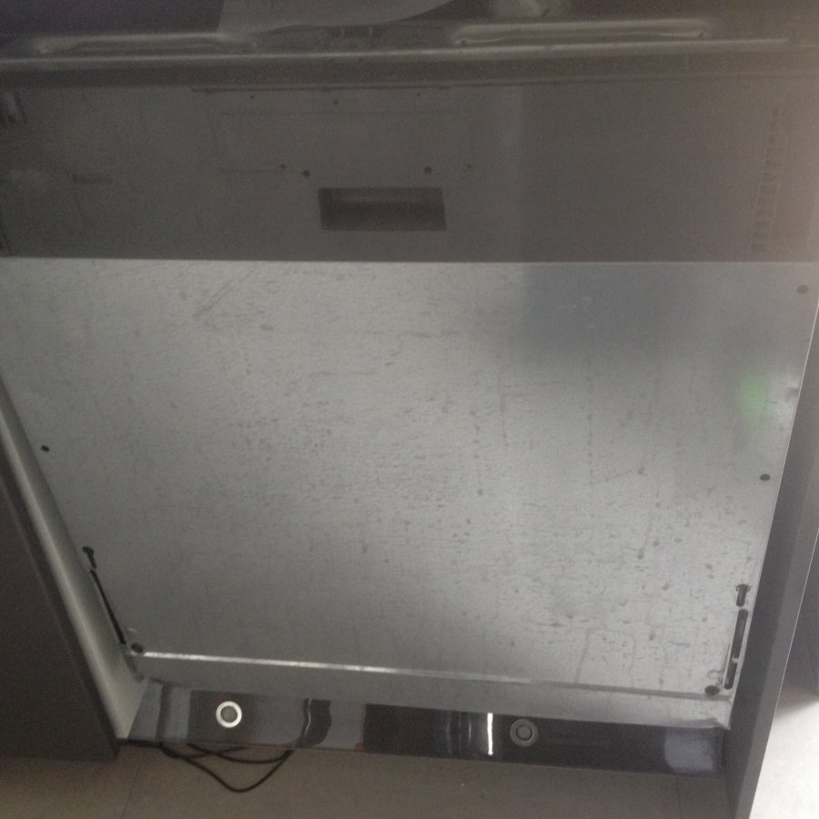

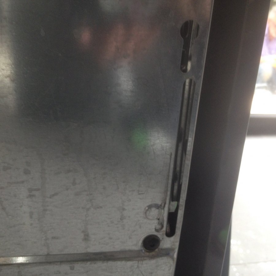

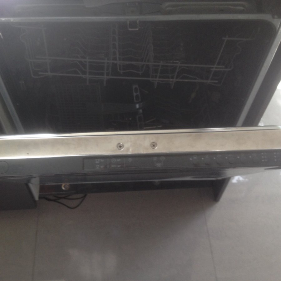

show us photos of the front side and top of the door, and any fittings.
Thinking of older appliances I have had, there is often a frame or channel that is screwed to the door and the décor panel slides into that. It can be U-section or L-section and there may be screws you can loosen to adjust it for thickness of the panel.
More modern integrated appliances have had a 2-piece fixing, where one part screws to the appliance and one to the panel, and they slot together.
I am guessing yours is an integrated appliance though you don't say so.
Have you downloaded the installation instructions? You will need the model name and number. It is easier with Bosch as they have exploded diagrams on their online parts directory.
Thanks John. Will get photos later of both fittings and front of d/w. And yes, it is integrated. Forgot to mention that bit. The installation is not a problem as far as the plumbing and electric side of things. It's just the cover panel which is the problem.
It looks to me as if the White plastic round nuts go into the channel on the top sides of the door. They do fit. And the other screw pictured with the White plastic looks as if it fits into the small channel at the bottom above the long channel. Again, it fits there.
