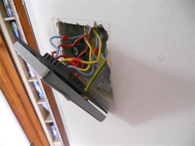

Firstly thanks to ban-all-sheds for that gem of wisdom ...although I'm not entirely sure how that will help me out of my current predicament.
OK, I fished out my original diagram from the kitchen bin this morning (nice) and reconnected my original plastic switch. All of the lights then worked correctly, with the fancy single switch still connected.
I then transposed the wiring to the fancy double switch and although the switches all work the lights as they should, the double turns the lights off in the on position and on in the off!
Now my logic fails me as I disconnected the wires again, turned the switch over and reconnected all the wires but the switch still operates upside down. I have looked at the possibility of turning the switch over in the housing, but due to the design that is not possible.
Below are two images, the first is my attempt at a wiring diagram (please excuse the armature nature) and the second a photo of the switch in question.
I can of course give you more information, but didn’t want to take the light fittings down if that was now unnecessary. I have a multi-tester (with continuity), but am uncertain how to determine which is a switched live, and rather than blow myself up experimenting perhaps someone could give me some basic instructions?
My hope is now that a swap a couple of connectors round and the lights start to operated correctly, but I will await you feedback.
I really appreciate the amount of help I have received so far, and look forward to haveing some working lights tonight!!
MrBump180
Are those metal switches?
You must earth the metal faceplates. Take the earth wires out of the back box and connect to the metal faceplate terminal.

Hi SparkWright,
I can't believe it was that simple, I switched the wire as you said and I am up and running. Also, a big thank you for the tip regarding the additional earth wire as well. As soon as you mentioned the metal switch it was obvious there should be one, but I wouldn't have thought of it.
Below is a picture of the switch connected correctly and with the linked earth wire attached in the sleeve as you recommended, just in case I gave you sleepless nights!
