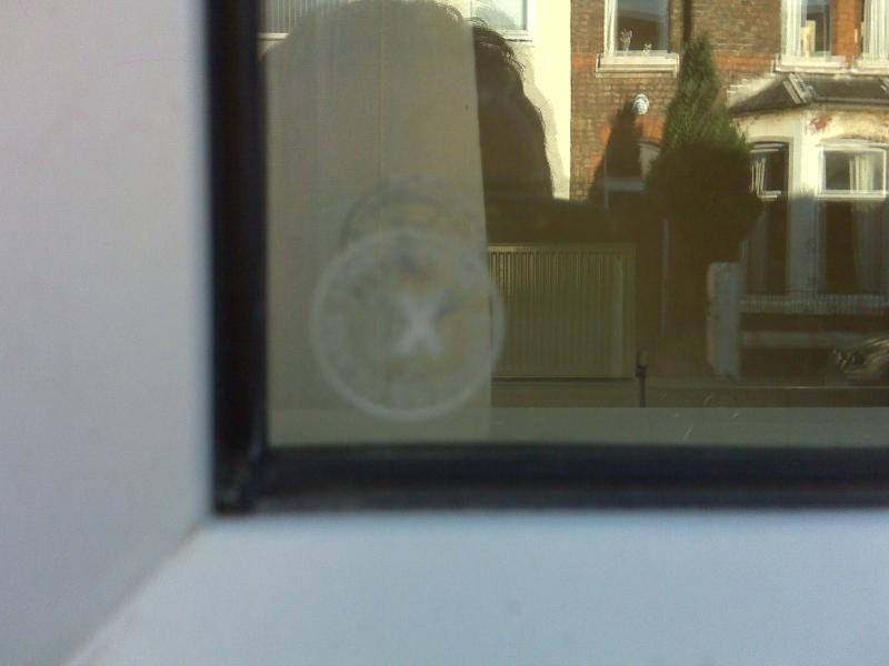

A few of the windows are below 800mm from the floor. Can anyone advise me of how to check if glass is toughen? (Other than by trying to though the council bloke through the window?!? :LOL: ).
Safety glass will have the BS kite mark in a corner somewhere &/or be stamped BS6262; no mark probably means it isn’t safety glass; also windows adjacent to doors must be safety glass. All replacement windows must also have low thermal e glass (K glass or similar) but it’s difficult to tell once the stickers have been removed so the BI may ask for other evidence it complies. I would think it unusual if it’s not, most units these days have it as standard even for conservatories which don’t have to comply. The window installation must also conform but don’t let the BI force you down the road of trickle vents or means of escape; these aren’t required & the only stipulation is the situation must be no worse than it was previously. I assume you’re aware the council will charge for an inspection & issue of a compliance certificate; that’s assuming everything is in order & they are prepared to issue one!

I've looked at some of the windows in my house below the 800mm level and they're marked BSEN 1279. Not sure if that is safety glass.
That’s just the insulation standard I believe; if they haven’t fitted safety glass below 800 or adjacent to doors they may have broken the law & not just ignored Building Regulations.

Having looked at the windows in daylight, there is no BS6262 marks on the windows below 800mm. However there is an Express Glass mark EN 12150 (which from googling I understand to be toughened glass). I assume toughened glass is the same as safety glass?!?
Picture attached for the benefit of any future forum users trying to ID toughened glass like mine
