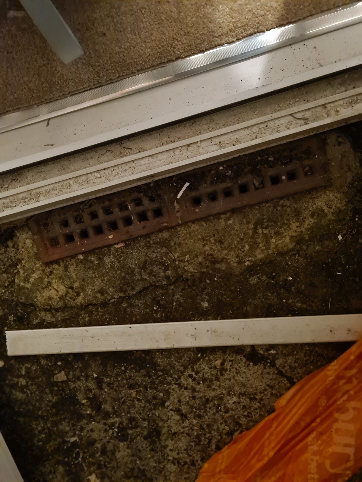

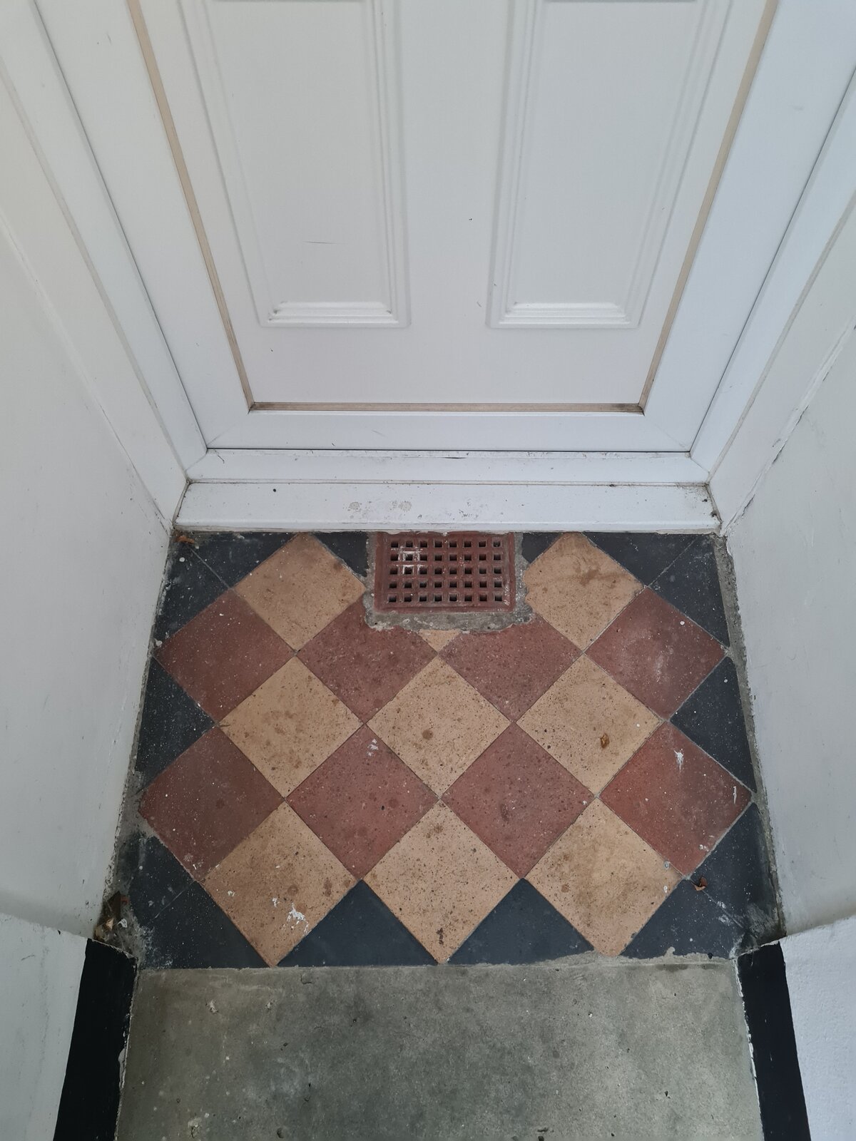

Airbrick installed pointing downwards outside front and rear door - won't rain go down them? What should we do?
24 Jul 2022
Hi,
We've just moved into a terraced house and there is an airbrick in the floor outside of the front of the front door and also the dining room door (which opens onto the side return at the rear). Both point downwards. They were blocked up with years of dirt and I have cleaned them out. However I'm worried that rain will go down them. This is less likely at the front as there is a porch over the front door (but is still possible), but rain could definitely go straight down the one at the rear:
Two questions:
Is this normal - I presumed air bricks were always fitted in vertical walls?
And if not, what do you recommend we do?
Thanks in advance,
Andy

Cellar ventilators perhaps
Or maybe some ignorant halwit raised the ground level beside the house, burying the original airbricks and most likely bridging the DPC.
Take up a nearby floorboard a look underneath. Take some photos and post here
On the basis that they have been there for years, and presumably put there for a reason, do nothing.
Damp in an under floor void is perfectly normal.
