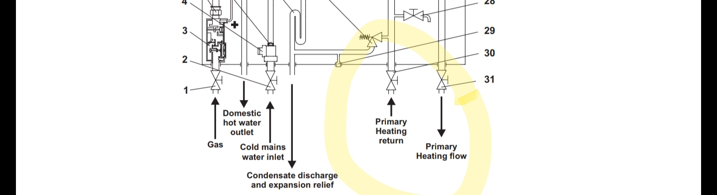

I am hoping someone can help me. I have just had a new ETEC 28/33 boiler installed. The pressure has gone down to zero and the filling loops aren't doing anything when turned. The radiators had to be bled and a lot of water came out.
Would anyone know how to fix this please?

Pics of the filling loop may help. Are you sure you are using the correct valves on filling loop ?
This is a diagram of the two taps I think are the filling loops
If its the circled bits ,they are isolation valves ,not what you need.
P.s the pics short of detail.
I am not overly f
amiliar with your boiler model ,but I think you have an external filling loop. Look for a braided ,silver coloured flexible hose. Or post a pic of pipework below your boiler.
your boiler does not have an internal filling loop, dont touch the valves that you have circled, follow the cold water inlet pipe and you will see a silver (usually) hose between that pipe and the CH return , you need to open these valves until the pressure reaches 1.5 Bar, then close them again
Thank you everyone for your help. The filling loop was quite a bit away from the boiler, but I found it thanks to your great help. Much appreciated.
