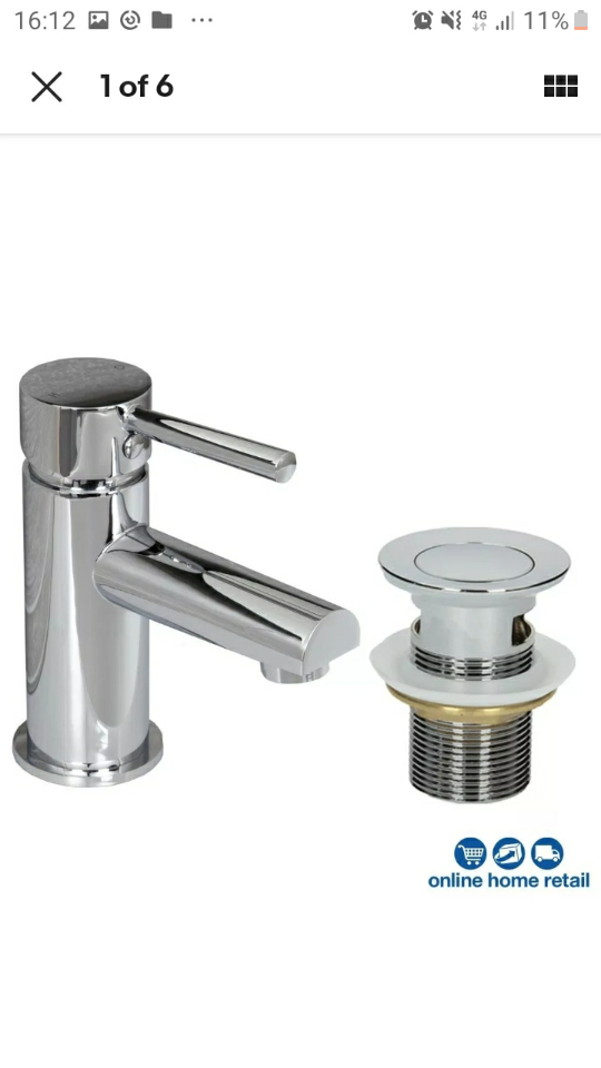

Hi
Just replace my basin and taps with mono mixer along with m10 flexi
The hot water flow is poor
If i remove the isolation and replace flexi with copper m10, will the flow improve

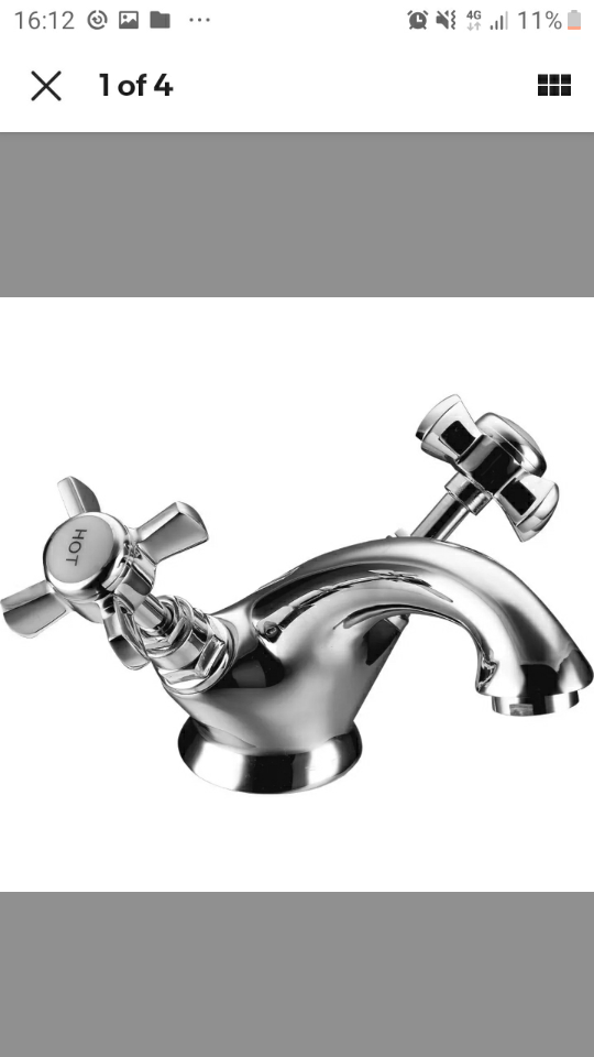

My old basin worked great with 2 taps

Try connecting the flexi to just the isolation valve, and fill into a bucket, if this comes out ok, I’d be looking if the tap is suitable (as per @denso13).

The only one that may work could be the Victoria taps due to having cartridges.
An old-fashioned tap with a washer is likely to be best.
Individual taps rather than mixers.
The best make I know is Bristan
If you look at the "regency" basin or bath taps you will see the shape
though they might not be to your taste.

Have a look at Screwfix. The product info says whether suitable for high/low pressure or both. Of course it will depend on just how low your pressure is. 0.1bar for every metre of height between tap and cold water storage.
Hi
Current tap is 162611
Planning on purchasing 162614
Says low pressure and gravity
