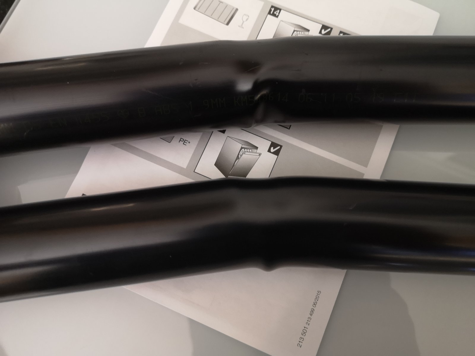

Well, I gave it two goes and I don't think I'm destined to have a career as a professional bender... But if anyone else finds this here is what I tried and what I think went wrong (apart from my lack of skill!).
I cut a couple of 2-3 foot lengths of 40mm in black (to hide the scorchmarks!), then took two short lengths of 32mm and wrapped gaffa tape around until they were a snug fit in the 40mm, in order to maintain the shape... I probably needn't have bothered as the ABS remained rigid apart from the area I heated.
Using an electric heat gun that was stood pointing upwards, on a medium setting (and finding the manual had instructions on forming plastic pipe... albeit much smaller pipe!), I rotated the pipe whilst moving it too and fro. The first pipe (bottom) I was surprised how long it took, but when it went it suddenly became quite plastic and I put a bit of a kink in the interior radius of the curve and stretched the outer radius a bit more than I'd like. Second pipe (top), I used a beer keg as a former to try and avoid the kink, and heated a greater length of pipe... still managed to kink it. Pah. That would be a nice place for drain clogs to grow.
I think the "Pack with sand" suggested somewhere above might help, but I think my two key faults were:
1) I think I was trying to heat the pipe too quickly. Obviously some of you have had success with a hot air gun so skill comes into it, but a novice approach might be to pre-heat the whole pipe in the oven to around 90celsius, then using the heat gun just to finish off the area for bending.
2) I think I tried to bend the pipe too quickly so it only bent in one place... Once it became pliable it just went, but if I had it laid down on a sheet, I could have nudged it a bit, moved along, nudged it a bit, moved along etc.
Thanks for the advice, at least I know it's possible!

I would suggest that you want to make up a wooden former on a jig too to keep the inside radius as smooth as possible as that's where it will kink. A piece of thin ply bent to the radius you want and cover it in foil or use a heat mat
