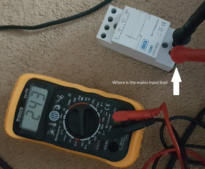

The Spec(if you can believe it) says it is rated at only 0.33A at 24VAC!!!
And that "spec" is for use as a door bell supply. Door bells only take current while the bell is ringing. They do not take current continuously.
Taking 0.33 Amp continuously could result in overheating of the transformer. If it has a thermal cutout this may have operated and this would explain the lack of output from the transformer.

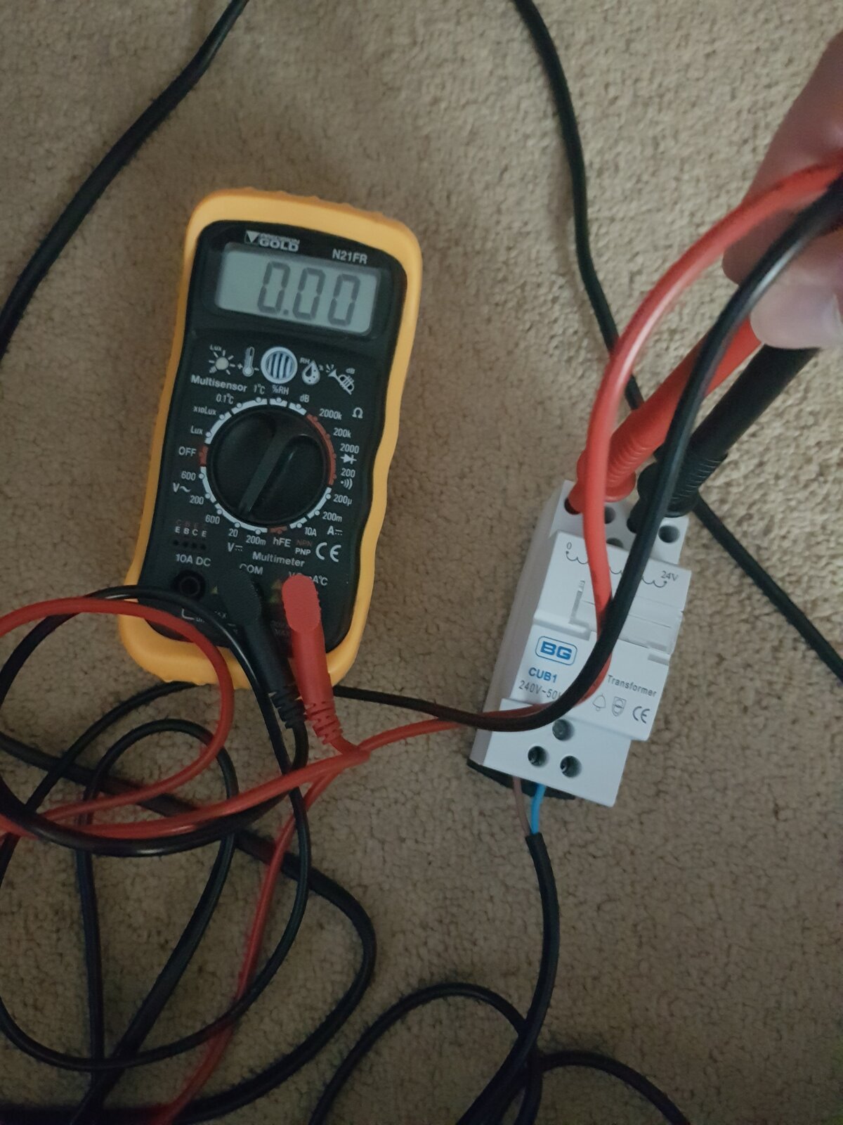

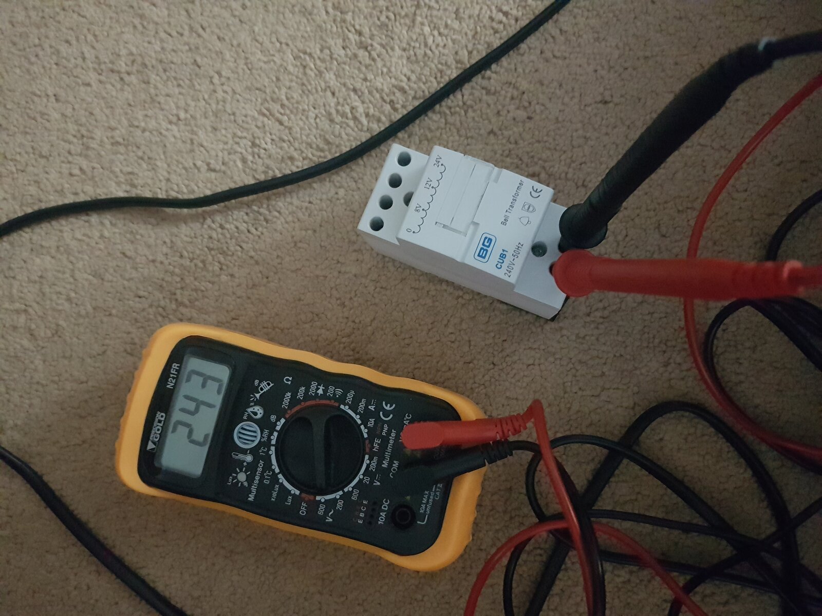

Well. The data sheet claims they output dc. The data sheet was also written by someone with no technical training so is complete nonsense. (It apparently has a constant power output - I don't think so!) It sounds like you may be doing something wrong though. Maybe a picture of you testing it would help?
