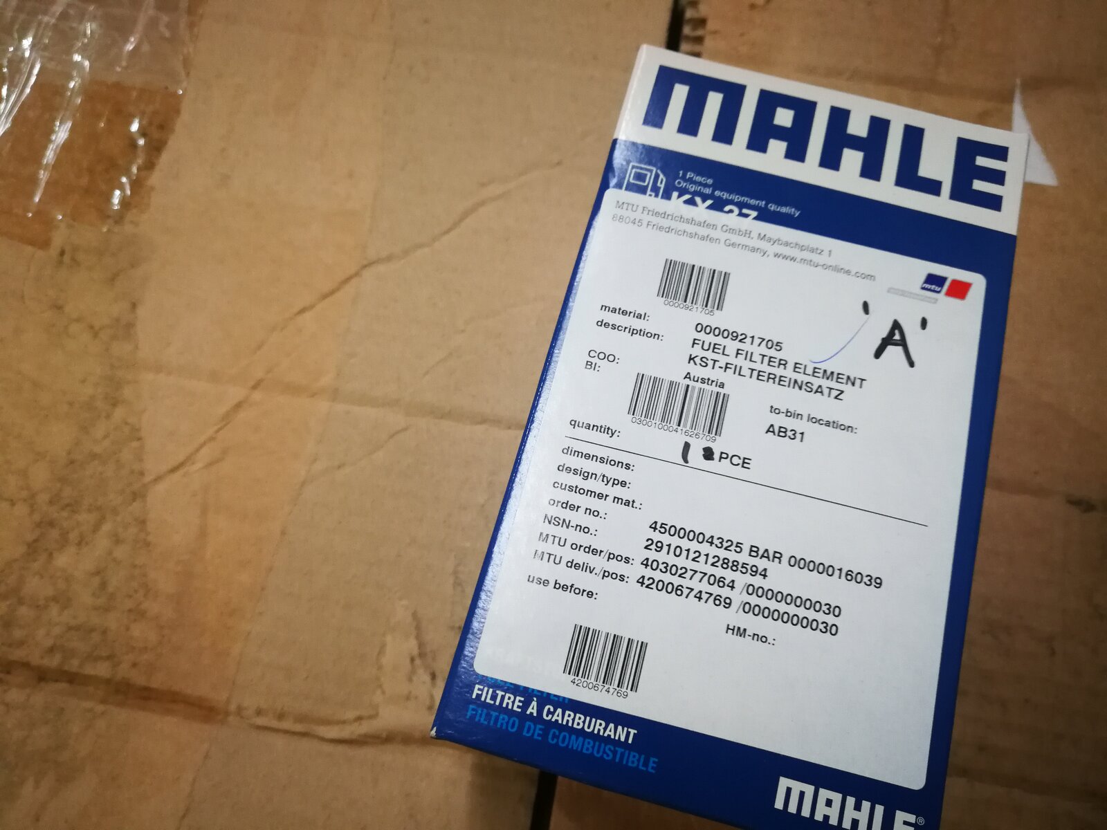

If people say the aftermarket equivalent from the same manufacturer (i.e bosch aftermarket to Bosch OE ) is of lesser quality then they are advising a myth. This is not the case, it is not worth the costs of installing a completely separate production line just to produce an aftermarket component.
In some instances OEM's will even supply you with aftermarket boxed products with there own labels on when they have ran out of the OE branded boxing (see PHOTO)

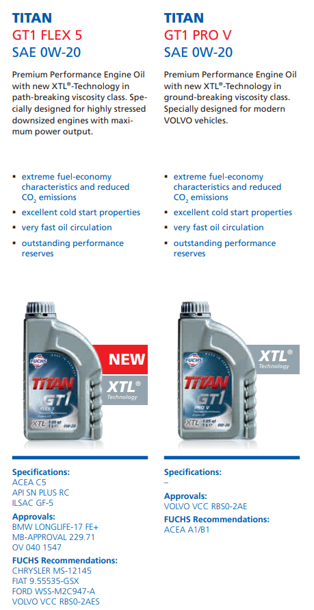

Oils - You do need to be careful with oils, there is 2x wordings, which sound like they mean the same however they are very different. These are:
"Recommended for" and "Approved for" (or has manufacturer approval)
For an oil to be approved by the manufacture, the oil company must send in a huge sample to be tested, this will be done in a laboratory and on a test cell, i now MTU send the oil out to test mules they have in volatile conditions like mining sites in Africa which they will send the oil to to be field tested for 1000 hours, you will then get a certificate of approval once completed.
To get approval is an extremely expensive and thus only the big oil companies will generally spend to obtain the approval (many of which also help design and blend the specification with the OEM's)
The "recommended for" are usually cheaper oils, and they are not tested, they will be the oil manufactures own advice based on the blend and structure of the oil.
in some instances this is done to enable the oil producer to either keep less product on the shelf, or for the end user to keep less product type, (for 5w30 oil there was about 10 different specs at one time) an example can be seen in the attached Fuchs oil.
