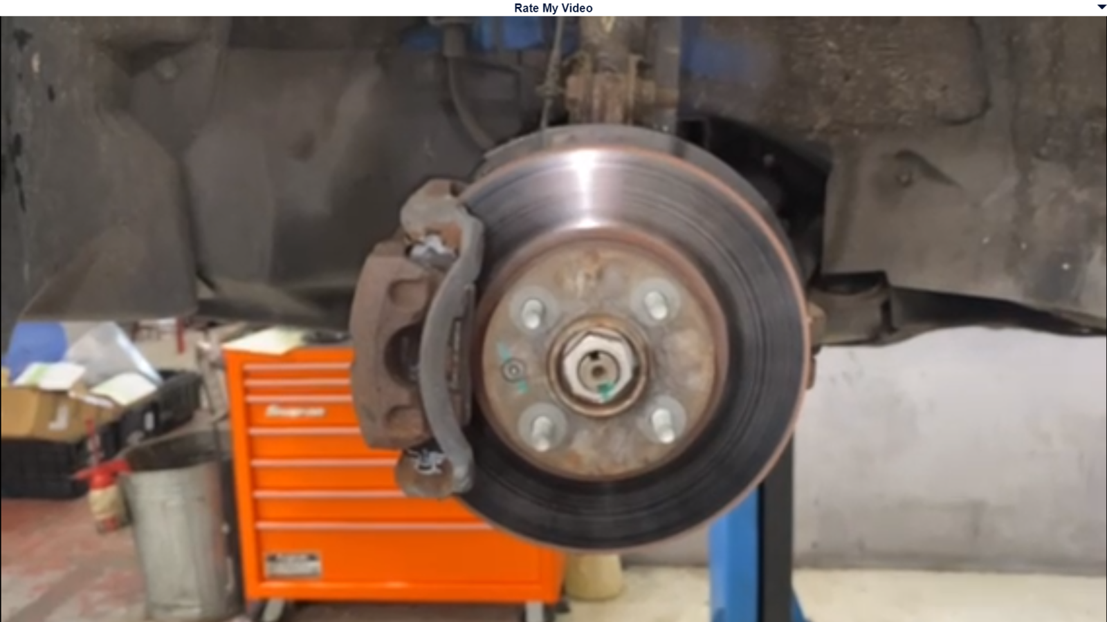

My garage has recommended changing a brake caliper on my Chevrolet Aveo auto (2012) if an intermittent fault keeps happening (lh nearside brake doesn't fully release and overheats, steering wheel wobbles). There are two types listed and mine is for a 256mm disc. But there are none available; plenty of 276mm ones though - would this fit my system? Or any advice about where to source a caliper for a 256mm disc? The garage says that they will fit it if I get it.
Plenty on ebay. I think I mentioned it before in your other thread.
Hi again Mottie. Can you link me to one or two as I can't seem to find any. Thanks.
I've done some more investigating. My car has 15 inch wheels whilst some Aveos have 14 inch. Is it safe to assume that the bigger wheel will need the 276mm calipers and that the smaller wheel takes the 256mm? Or doesn't it work like that?
Sadly you cannot guarantee such a thing - although at times it may be applicable.
Unfortunately you need the exact diameter of disc too as running clearances between disc edge and caliper are pretty tight. On occasion I have been able to replace the disc and caliper with bigger ones, but only as an axle set.
Caliper repair kits are available so long as yours is serviceable - in other words the bleed nipple hasn't sheared off etc.
John :)
Here is a photo sent by my garage. Is the disc diameter measured including the brownish circle surrounding the shiny part? Any ideas from the photo as to size? I don't want to take the wheel off if I can avoid it. I have measured the distance between the nut threads (in the photo) as 45mm and on the car they are 70mm. On the photo the disc is 145mm. Those are the measurements on my enlarged image but your screen might be different - the ratios will be the same, of course. Anyone good at maths? I think I have the answer but let's see if we agree! Question - is this a 276mm or a 256mm disc. Have 12 A*s (sorry, grade 9s) for the correct answer!

As it's intermittent I wonder if it is the caliper.
I've had it in a couple of cars where the brakes were binding because of the caliper carrier (the bit where the pads sit) had corroded and was filled with brake dust. Removing it and cleaning it properly with a wire wheel cured the problem.
No you can't just put calipers from a bigger disc on.
You can send the caliper away for repair, plenty of places are able to do this and takes around 5 days, in my experience brake engineering were the best for this, it will need to be done via the garage or a motor factors.
Troutybrown has advised how to measure the disc.
Wheel size alone does not denote what size disc you have.

The easiest way I know to measure the diameter of a brake disc is holding a ruler to the edge of the disc, parallel hub's axis, then measure between the ruler's edge and the hub centre, then x2 the measurement. May be a bit off because of rust on the disc edge but you can tap that off.
