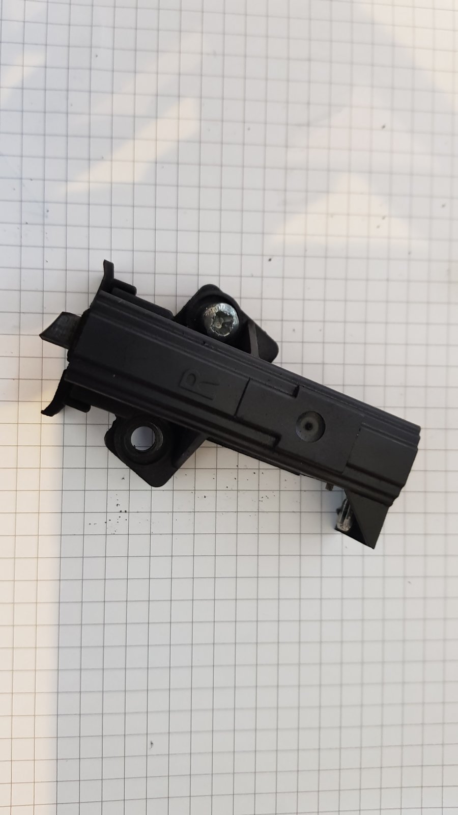

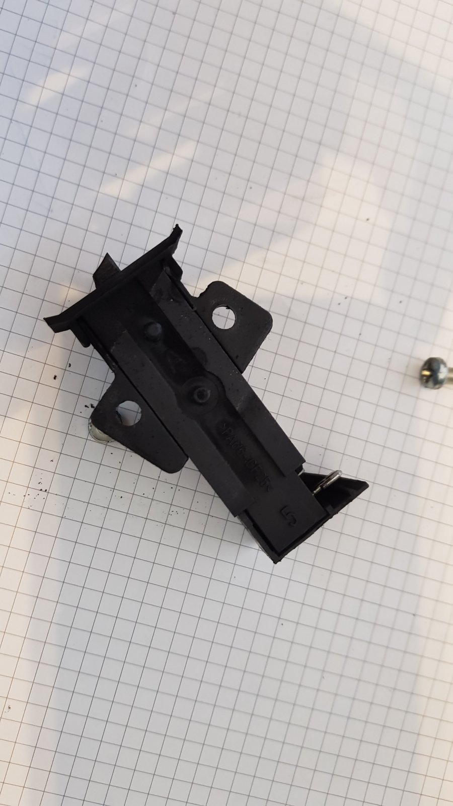

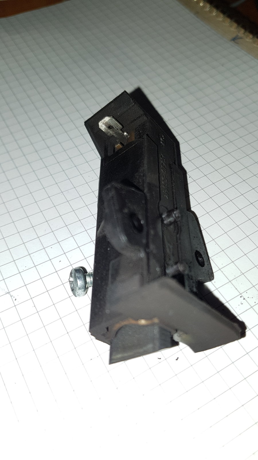

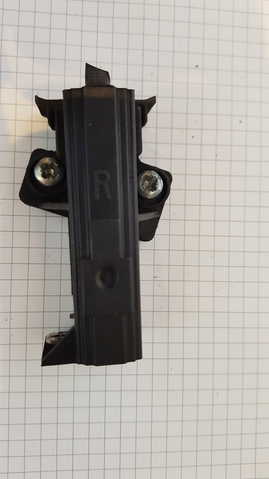

Hi,
According to many online resources, my Whirlpool AWO 12763/1 takes the following brushes:
481236248004
https://www.servis-whirlpool.cz/nah...-13-6x5x32-mm--leve-481236248004-481236248004
(Yes, I live in the Czech Republic, and no, I cannot speak Czech!).
However, in the washing machine there appears to be an older type of brush with an R on the top and a connector coming out of the side instead of the side. (PHOTOS ATTACHED). The plastic guides do not fit into the holes and the screw holes are in a slightly different place.
Does anyone know where I can get the older type of brush?

Try AEG, Zanussi, Electrolux part no. 4006020327. it goes by the make of motor used.
