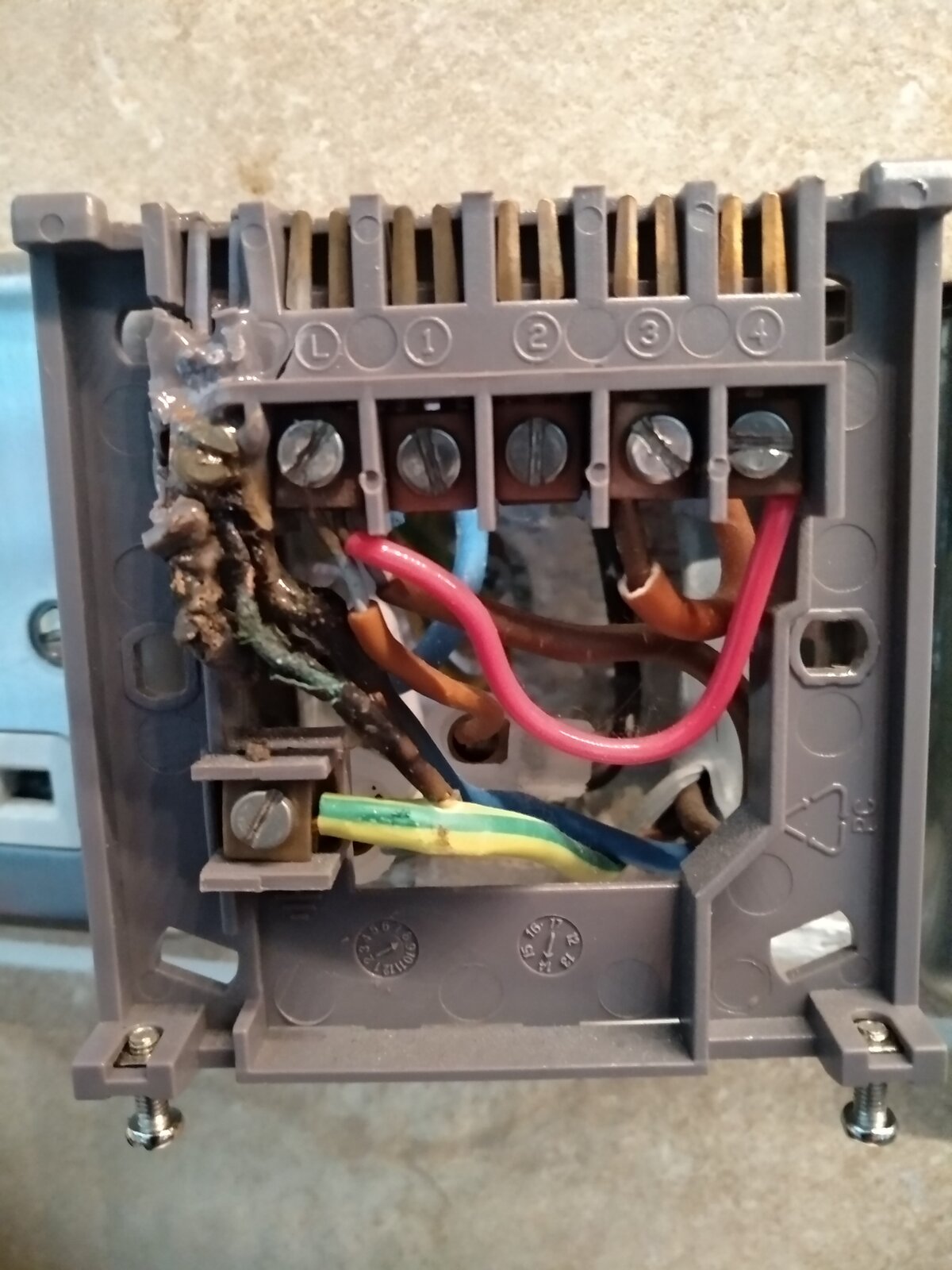

Hi there. Ok so came back to no display on the timer! Couldn't see anything blown. So isolated to switch. Took off the unit an salus ep100 and found the first image attached!!!!
I disconnected the unit and found the fuse in the isolating switch must have tripped it out. Power goes to this unit when I power it up.
Ok so issue is can anyone tell me what went wrong!!
And can I put in just s regular timer for my heating now. It's not zoned at this point and is just straight wires out to the boiler.
The only thing I can think of is that....there is a feed that comes from the boiler to a small shed which houses the washing machine....the washing machine would have been on when the timer kicked it....it had been previously like this for quiet a whole with no issue.....
In the interim is there a way just to use the isolating switch to turn on the boiler ? Use it as the on/off switch per say......

It would seem an overload on neutral, think unlikely a correctly wired timer would have anything like the load on the neutral to cause that even with a lose connection. So it seems likely some error, most units using that plate fused to 3 amp or at least rated 3A and although not impossible with a loose connection to cause that damage, it raises the question where does that outgoing neutral feed?
Borrowed neutrals are very dangerous, and it seems likely you have a borrowed neutral.
Hi and thanks for the reply. It does appear to be borrowed.
I followed this wiring.
So we have from the breaker a
Three core into a 13amp isolated switch.
This then feeds into the timer for the boiler, which is now needing replacing.
From this
There is a five core cable going to the boiler and being then split to have the three earth, live, neutral feeding to the boiler itself/pump.
The other two wires black and grey were being used to feed a three core to the shed we have.
These black and grey were being fed from the timer box connections.
Could you tell me how this should have been done so we can ensure our electrician does it correct.

Unreadable due to melting then L 1 2 3 4 it seems reasonable to assume melted wire is a neutral.
