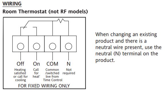

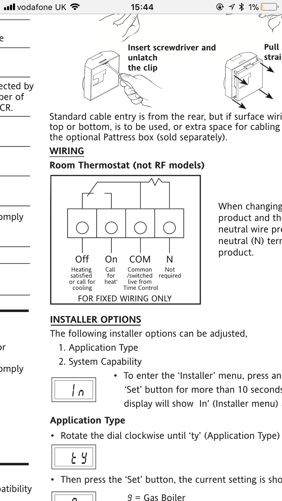

So the drayton digistat 30002 looks the best fit for us.
I’ve attached a screen shot of the wiring diagram.
Would I be right In Thinking that
Honeywell term 1 -> Digistat ‘COM’
Honeywell term 2 -> Digistat ‘N’
Honeywell term 3 -> Digistat ‘ON’
Or have i got it all completely the wrong way round :ROFLMAO:
I had a feeling crossing circuits over wouldn’t be a good idea!
Thank you so much for your help!

I think you're right about it being broken. A friend of mine had same roomstat with similar problem. There was a wire connected to terminal 2 (for the anticipator heater), but it wasn't connected to neutral at the other end. Thought that was causing the high differential. Corrected it but it made no difference. At first I'd assumed the stat had a bimetallic diaphragm sensing element (unlikely to fail) but investigating on the internet it turns out it's a filled bellows, which must have leaked. It might be worth just checking the anticipator has a neutral, but if the stat worked OK in the past but now doesn't it sounds like it's had it.

Sounds good to me. You don't need the neutral, but they kindly provide a terminal for you to use. Odd then that they show an accelerator heater connected to it, that will be permanently 'on' rather than only 'on' when calling for heat...using a wire that is 'not required' :confused:
Agreed the connections shown look odd. You wouldn't think a published diagram would get it wrong, but I'd expect it to be wired as per the diagram in the original post - anticipator energised when calling for heat. Maybe it is but diagram wrong. Easy enough to check if you have the stat on the bench.
Thanks!
Would it be beneficial to just make the neutral safe and leave it behind the thermostat in the wall if it is not required?
You could. That is probably what I would do.
