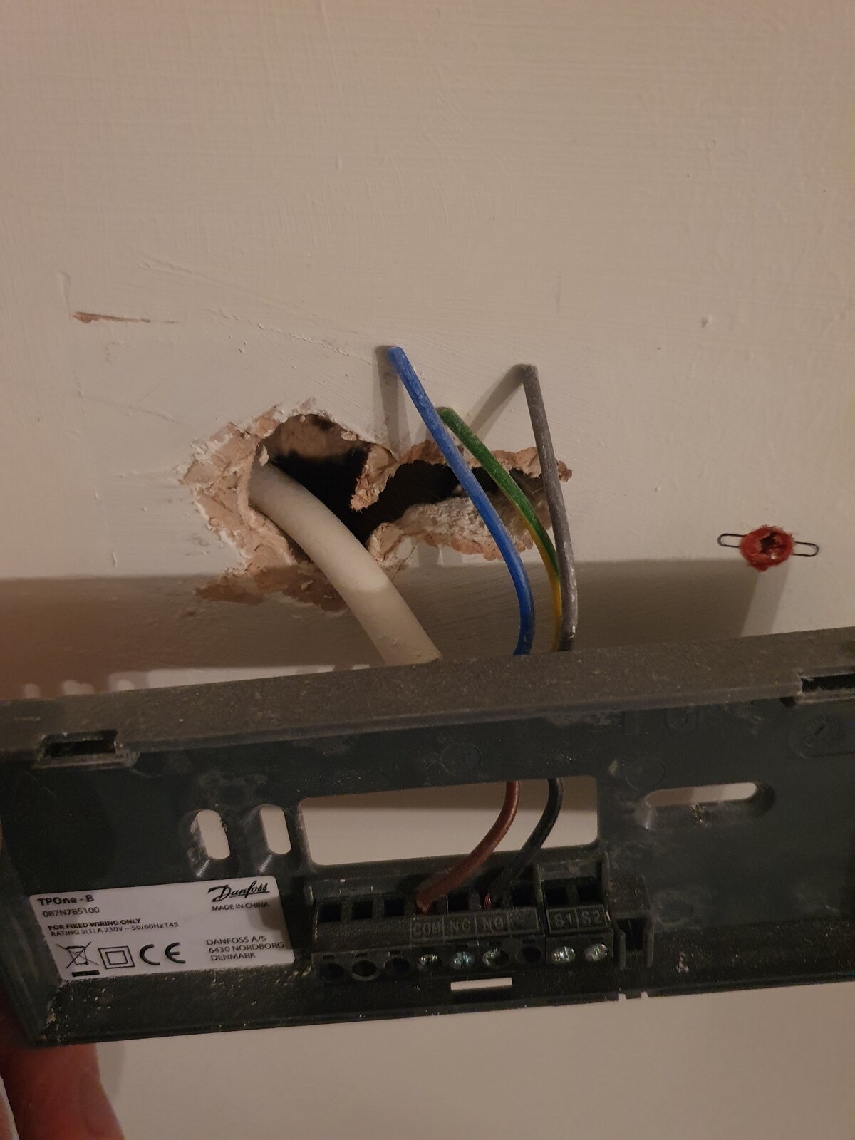

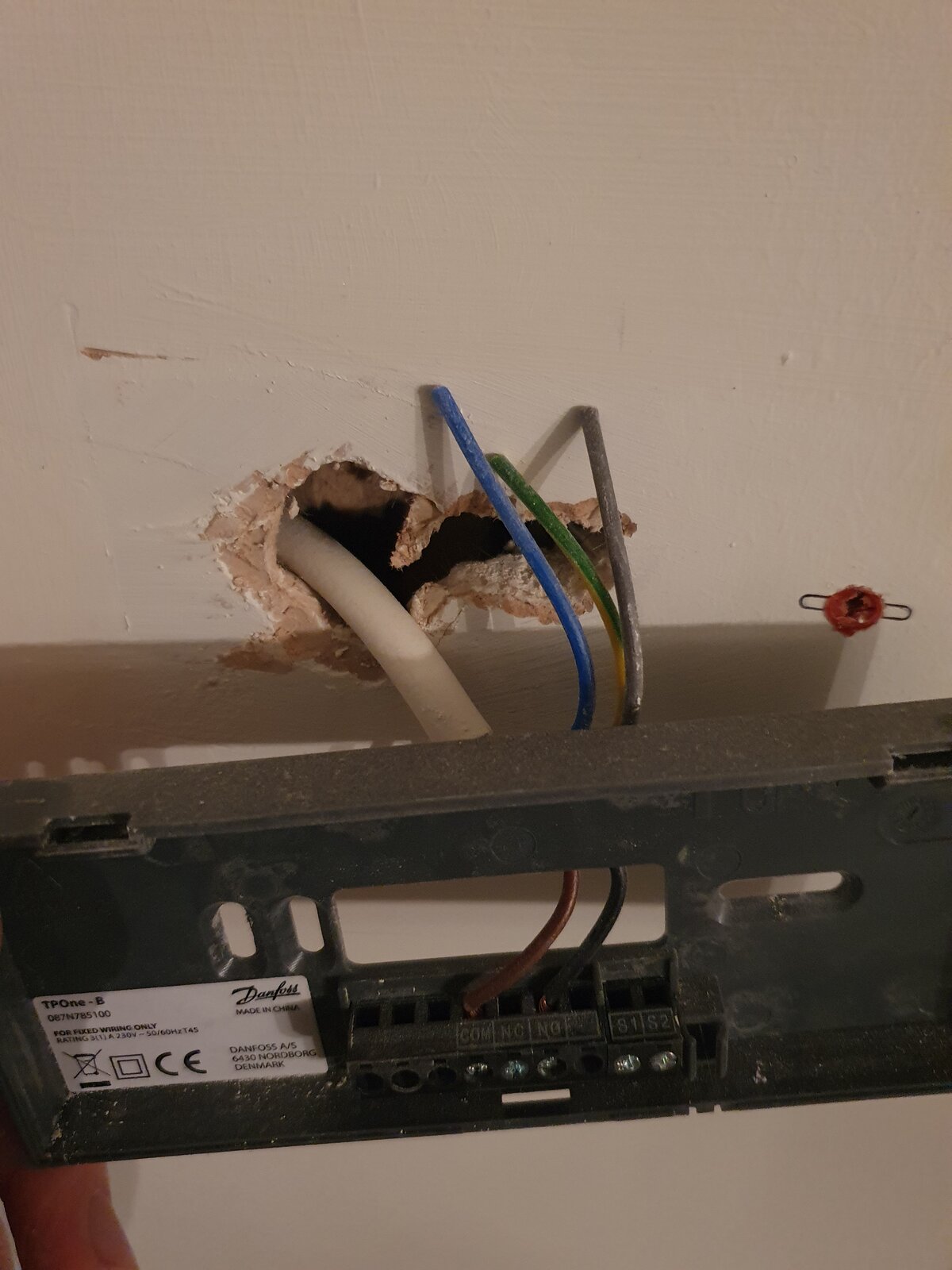

Bought a new build and brought my multi zone hive from the previous house and finally got round to installing it albeit 11months down the line.
I have a danfoss tpone-m downstairs and that has been successfully changed. However the thermostat upstairs is battery powered tpone-b (see wire setup attached).
Does this mean there is no power there?
Thanks in advance!! First time poster

It means there’s live and switched wires. The others are there, so may need connecting at both ends.
Yes and no. As you have figured, the existing thermostat is battery powered whilst the Hive receiver is mains powered.
The heating control wires are a straight forward swap:
The brown wire in 'Com' would go to the Hive 'Common' (1)
The black wire in 'NO' would go to the Hive Heating on, also marked 'NO' (3)
You then need a 230V mains supply that is supplied via the same 3A fused connection unit that supplies the boiler and the rest of the heating system connecting to N & L
Usually Zoned systems utilise motorised valves, so I would expect the brown wire in COM to be a live, if so, that can be linked to (L) and then you will only need to add a neutral to (N) and as @CBW it looks like you have an unused blue wire that could be utilised for this purpose.
Are you going to mount the receiver on the wall where the current thermostat is? Usually the Hive thermostat goes there and the receiver is located in some inconspicuous place out of sight which is usually in a cupboard somewhere adjacent to the wiring centre where all of the wires you require would be available including the 230V supply.
